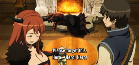

The background girl says the bottom line, then 2 seconds later, the foreground girl says “please forget this”. Both stay on screen.
On the wd player, the “hero… hero” line goes away after 2 seconds.
On longer lines, this does get annoying…
