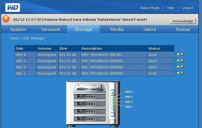

I have 4 HDD/ 1TB on Share Space. But it just run Raid 5 for 3 HDD 1,3,4. HHD 2  is Unassigned as below
Now HHD 4 has been Failed. So can I replace HHD 2 to HDD 4 ? Do i need to backup the configuration ?

I have already Replace the Fail Disk , but after reboot, the status of ShareSpace display like below with " Datavolume doesn’t exist " and  " Unassinged ’
The Raid 5 is fail too.

Seems that the Raid rebuild process was not done
