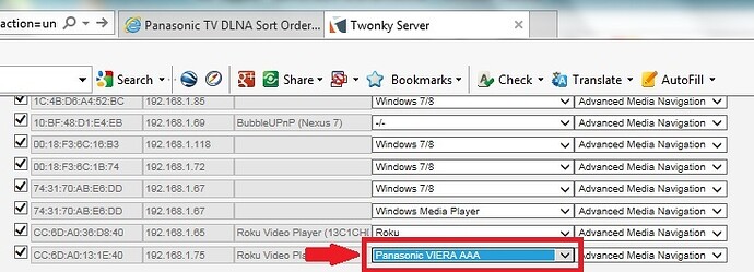

What are you using to try and change the file? I was able to change some info in the “Panasonic_VIERA.xml” file located in the “/usr/local/twonkymedia-7/resources” and save it using WinSCP (https://winscp.net/) on a Windows 7 PC. I changed the DisplayName value to the following: <DisplayName>Panasonic VIERA AAA</DisplayName>
After rebooting the My Cloud the change is reflected on the Twonky settings page. Below indicates the changes:
The problem is with new hardware the folder has been relocated to \modules\twonky\ and the modules folder is read only. The only solution I have found thus far is to put all my videos through mkvtoolnix and the date will change to present date although I admit this is not a proper fix
