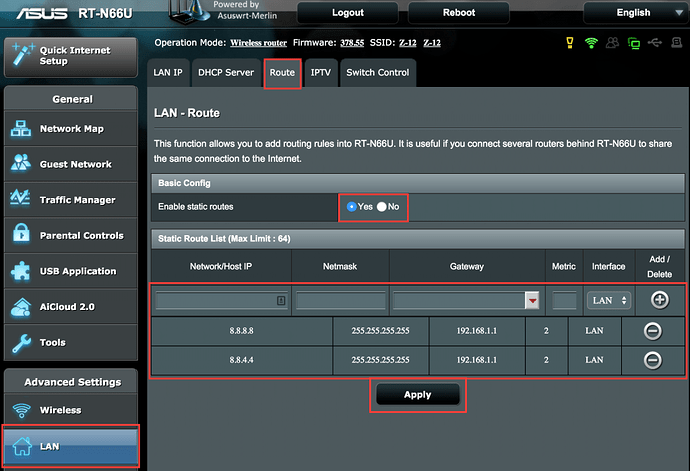

Some consumer routers (like Asus) have ways to block clients from using hard coded DNS servers. An example for Asus routers: https://12vpx.com/docs/block-google-dns/asus
Personally I block broadband access to a first gen v4.x firmware OS3 My Cloud along with block the Google DNS servers for the local network clients who have Google DNS servers hard coded.

If using an Asus router with Asus-Merlin firmware and running a Pi-Hole, one can use the DNSFilter option to force all DNS requests through the Pi-Hole.
In the LAN > DNSFilter section:
Set “Enable DNS-based Filtering” to On.​
Set “Global Filter Mode” to Router.​
Leave “Custom (user-defined) DNS 1” (and DNS 2/DNS 3) fields blank.​
Input or select the Pi-Hole device MAC address in the “Client MAC address” and select “No Filtering” as the Filter Mode.​
Then click the Plus icon to add the entry.​
Click Apply when finished.​
One may have to reboot the Asus router after setting up DNSFilter. Also Pi-Hole recomends putting the Pi-Hole’s IP address in the Asus LAN DHCP DNS server field entries and not in the WAN DNS field entries like Asus suggests.
https://docs.pi-hole.net/routers/asus/
https://www.reddit.com/r/pihole/comments/dfm5j4/guide_for_asuswrtmerlin_users_with_screenshots/

As indicated above, if one has an Asus router, one can block specific DNS servers that have been hard coded by local network clients. The example from the link blocks Google DNS servers:
