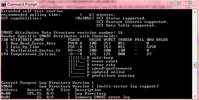

So for the short version (no pun intended) every other Ultra has given me the full set of attributes but here I only get these four. Any particular reason why?

There’s a few applications that can do so easily like crystal disk info. I personally use smartmontools because not only does it provide the entirety of the firmware’s/SMART logging i find it easier without a GUI. If you choose to install it the path will be set to run the commands from any directory otherwise you have to navigate to wherever it’s installed.
smartctl -x -d sat [drive letter with colon]
Order doesn’t matter except sat has to come after -d as that parameter tells smartctl the USB device has a SATA drive. I use -x but for the attributes only it’s either -a or -A. Under Linux instead of drive letters it’s whatever the drive is under /dev/.

It would be nice if you could report your output.
But it looks like these new style drives deliver the same four attributes:

It is normal for the 4 TB HDD included in the My Passport enclosures to only display four SMART attributes.
What do you call “normal”…?! You should explain us WHY it doesn’t show the others, especially power on hours count which is a basic and quite important one the day you gotta resell it.
