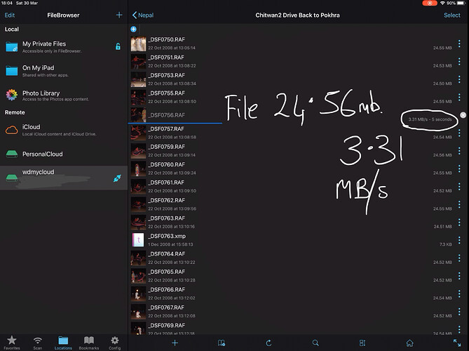

Using current router etc average is 15 Megs download upload 1.1 megs.
LAN averge 3/ 4 megs read write maybe 9 megs using laptop.

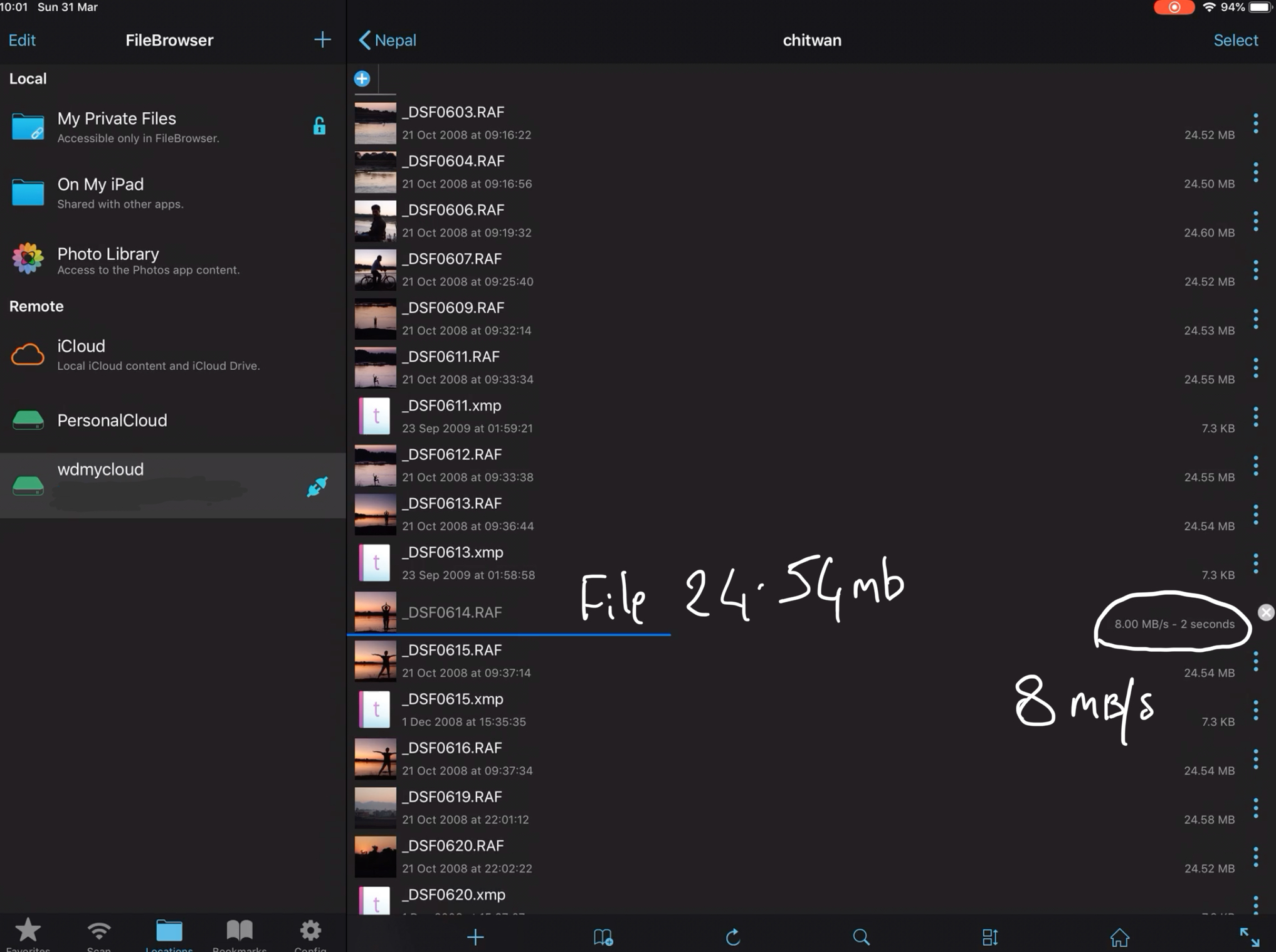

Out come newer router reading around 8/9 megs what other areas can I do to increase read and write ?

How are you determining your speed is “8/9 megs”? What program or software are you using to test for local network speed? Can you post a screen shot that shows the “8/9 megs”?

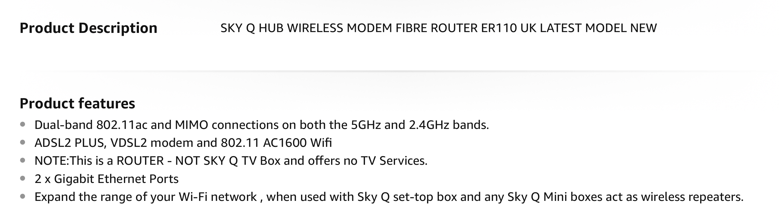

2.4 GHz router
New sky router not the sky q router, one before
ps I use file browser as it provides preview for raw images, I would have used WD app but it fails here it appears. (my Camera on the list of it should work)
If I were to repeat with WD app I do have a slightly faster speed.
apparently this router
