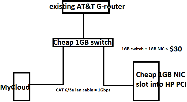

From your specs which is pretty low, let’s see your options (on top of what has been recommended by our fellow users):
  1. Stay wireless? If you can’t demand/request/opt for hardware upgrade from your ISP (AT&T), try to upgrade your Wifi router (this should also upgrade to Gigabit ports and work well with your existing Wifi-N), get at least the N model (cheaper) or AC model for future proof like this quite affordable TP-LINK Archer C7 Wireless AC1750 Dual Band Gigabit Router, 450Mbps on 2.4GHz + 1300Mbps on 5Ghz, 2 USB Ports, IPv6, Guest Network
  2. Go wired for speed? Get a cheap 1GB NIC Ethernet PCI card for your HP PC or easier a Plug&Play USB3.0-to-1GB-Ethernet adapter (edited: ops your HP PC only supports USB2.0, so best to get the previously said 1GB NIC PCI), get a cheap gigabit switch hooked to your existing router, then link MyCloud and your HP PC via the gigabit switch.
