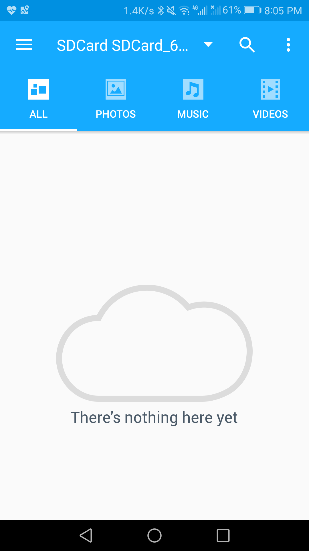

Today I formatted my 256GB 1000x 150MB/s Lexar SD card, hoping that my previous issue with SD card import was “just” something to do with that SD card being slightly bit corrupted by a sudden removal on a Windows computer while files were being copied, yet after my in-camera formatting of the SD card, I still am experiencing the same issue, today I filmed 46GB of videos, yet when I just tried to import those to the WDWP, it took about a minute or less to blink the first 3 LED and now it seems stuck forever on the 4th LED to blink, seems there’s no data that has been copied over from the SD card to WDWP, nothing is getting backed up and the WDWP acts weird on this SD card.
It says that it’s transfered something like 82% o the 46GB
but actually it has transfered nothing in the SD Import folder
Another thing I wanted to do today, is I left the WDWP by itself to “work” during the whole day to backup one of my 128GB Lexar 1000x 150MB/s SD cards using my USB SD card reader, but letting it work on it the whole day on the USB2 host port of my WDWP, if backed up only 6GB during the whole day it looks like
even though it seems my SD card had 115GB on it that I wanted to backup through the USB2 host SD car reader
I really hope that resetting my WDWP or following some of the other solutions you’ve written here will make my WDWP work as I expect that it should be…
So now I tried to reset the system on the device, resetting seems to keep the same firmware. I still have the same problem, nothing imports from SD card, when I click to import from SD card it goes through the SD storage at super fast speed like 4GB/second but at the end nothing was imported.
I recorded a screengrab video to show what goes on, seems nothing imports:
WDWP too fast nothing imports from SD card - YouTube seems it skips all the files, could it be because it thinks it already has them all on the drive?
