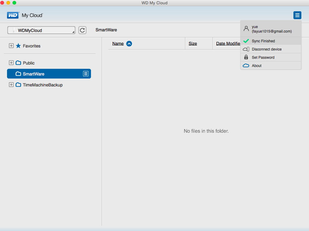

  Refer the firmware update from the WD website, I see below instructions, however in step 2, when I open WD My cloud, I can not see the Dashboard UI, how can I open the dashboard UI?
