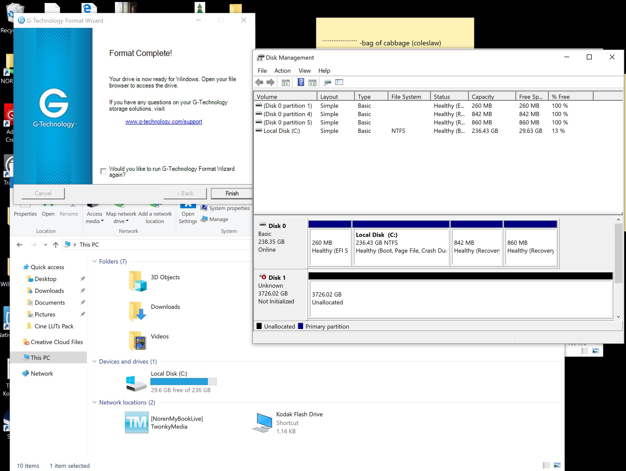

Okay, same day, new problem.
I’m not sure why you’re running into so many issues other than it possibly being a defective drive.
Right click on the disk 1 section and select Initialize. Select GPT and click OK.
Right click the unallocated space and select new simple volume. Click next all the way through the wizard leaving all defaults and click finish. The format process should take 10-20 seconds at most. If it doesn’t finish or remains RAW then you need to take the drive back for a replacement.
I took the drive in and got a replacement. Got the new one in and now I’m running into the same issues! I follow all the steps for quick formatting, and then it never takes. it has to be me right??
I also got this during cleaning could this be having an effect?
Yes, it should not be timing out. How do you have this drive attached to your computer? Are you using a hub or an adapter? Always try to attach external drives directly to the system, especially during configuration/setup.
If on a desktop system make sure the drive is attached to the rear of the system.
