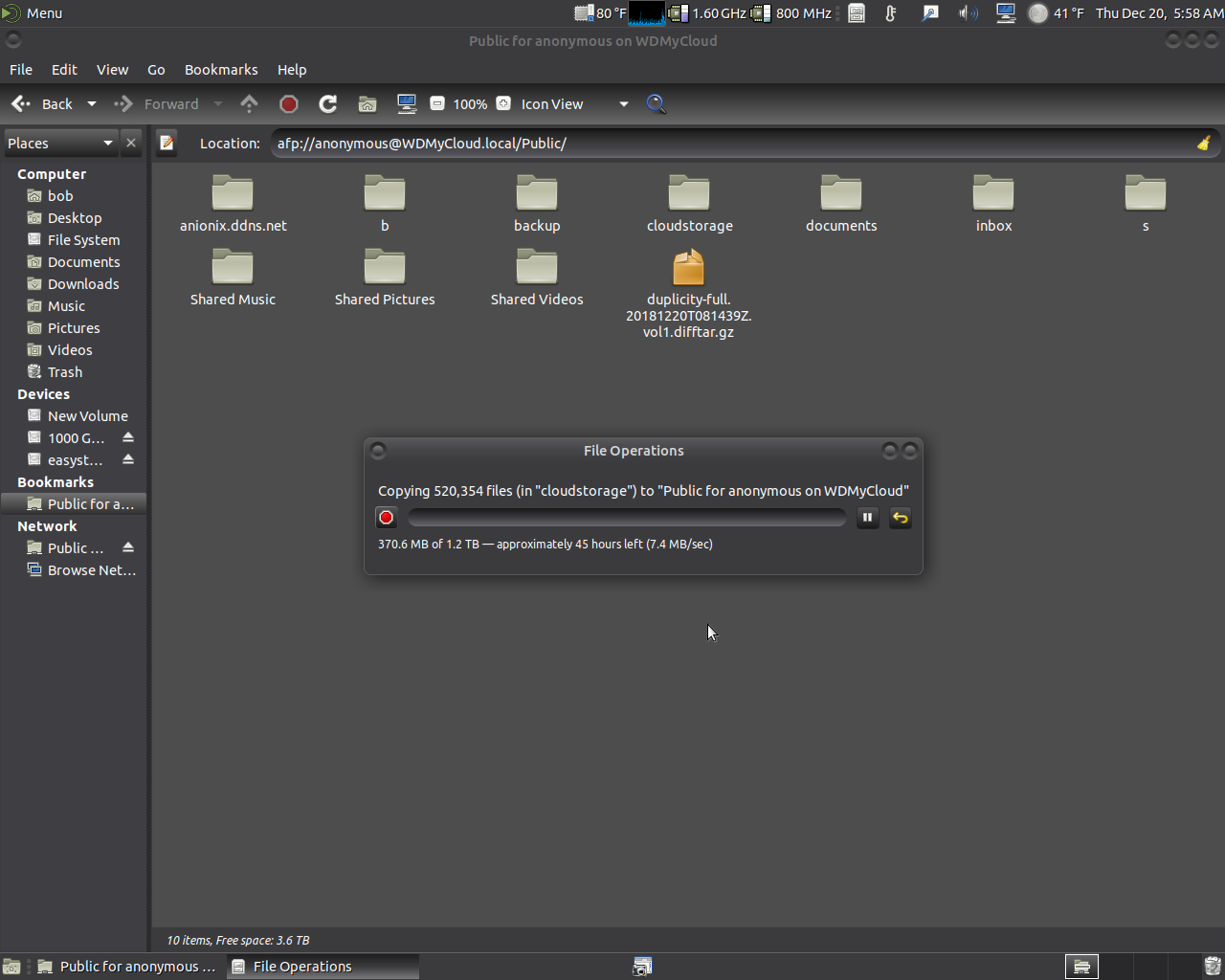

I have the same problem. Didnt really notice till last night I had to move some large data and was like oh my… Let me post some screenshots. Using NetGear R6250 Ethernet to Ethernet (GigaBit) But getting such horrible speeds. Box im sending from has 8gb ram/ Plenty of pcu. Hrmmm
