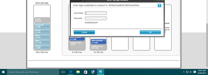

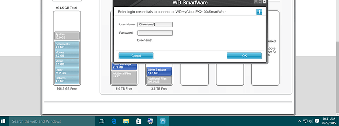

Hello there, I have just tested and here are the pictures.
Thats the smartware attempting to use the default workgroup to validate the credentials.
And this is the smartware changing to the drive name to accept he credentials.
Edit: Resizing pictures as they were to small.

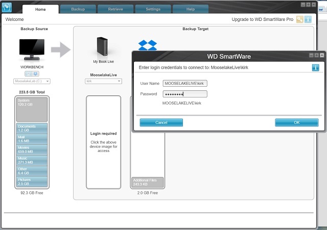

I guess that was some progress, I used upper case this time and it changed the hostname.  It may have last time (I had tried prepending the name) and I never noticed.  Also tried the same capitalization as the device name without any change (supposedly case insensitive so no surprise there).  It backed up for many months with W7Pro, no issues, and I restored a few files in the past to test.  I have a MyCloud elsewhere with Windows 8.1 and no issues.

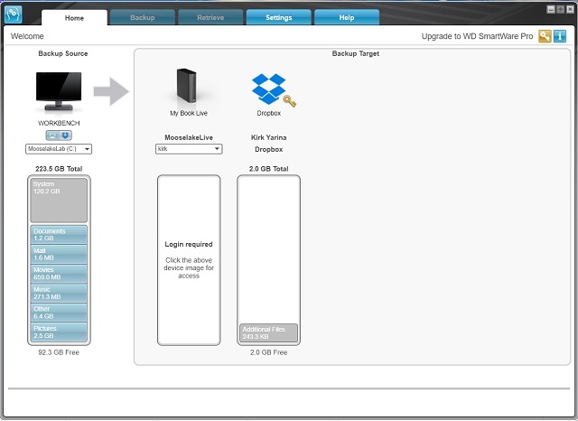

But it still didn’t accept it; I’m not able to get into the backup or restore tabs…  Yes, I used the correct ID and password, caps lock was off, no errors were displayed, etc.  And no new files in that share, last backup date/time was just before installing the Windows 10 upgrade.  It’s (possibly) trickier than just credentials, wonder if it includes the network name before the host (mooselake\mooselakelive\kirk) or j does something else.  I don’t have a way to monitor that, or do anything about it if I did so it’s not worth finding something and monitoring the switch port.  No alerts or logs on the MyBookLive about login errors so no help there.
It will enable the backup/restore tabs with an unproteced share, but that’s not good enough.
