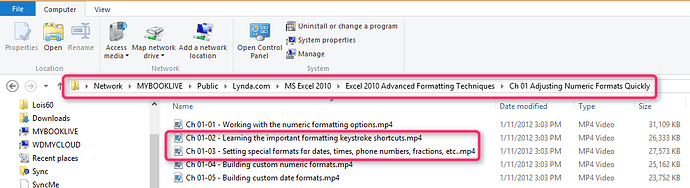

Ok, I think I figured out part of the problem - it appears that the files with errors have an abnormally long filepath/filename.  If the attached photo,I have highlighted the long pathname, as well as two files that are failing… the other shorter named files run fine.
After moving the whole folder to the root of the MyBookLive, I seem to be able to play the videos from my iPad ok now.
I have seen this problem before with the PC… but this case is different in that the files ran from the PC but not from the iPad.  Am I on the right track?  Is this issue fixable, other than by moving the folders to the root?
I was not aware iOS devices had path-length limitations. Another way yo confirm if by renaming the files instead of moving them to the root share.
The total path name length is definitely the issue… I tested by renaming the main folder with a really long name (added another 15 or so characters to the already long name) and now none of the videos will play from iOS, yet they still all play fine from my PC.
