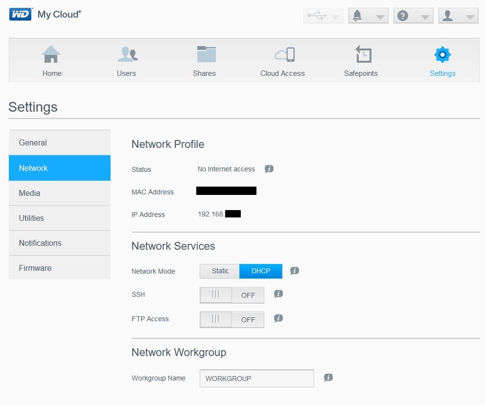

I have NO PROBLEMS accessing a first gen single bay My Cloud (or any of my other NAS boxes) on a local network when there is no internet access. At most I may have to use the My Cloud IP address rather than itā€™s name. For example, if I turn off the My Cloud. Pull the internet connection to my router. Boot the My Cloud back up without internet, the My Cloud Dashboard indicates No Internet Access. I can still access the My Cloud Shares.
