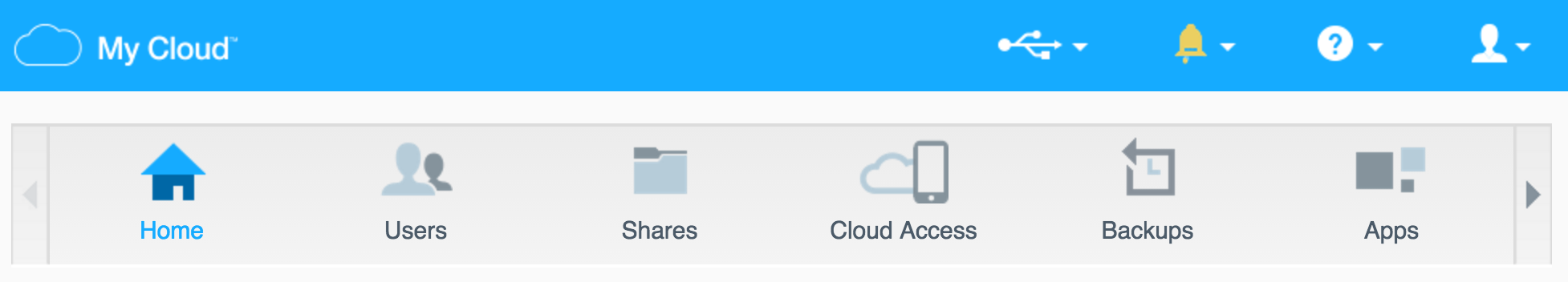

Thanks for the very informative reply! Ideally, I’d like to have an up-to-date backup of the data that resides on My Cloud on the external USB drive. Something that runs periodically and “mirrors” the data in case the My Cloud crashes.
Here are my options… Thanks!
Because your using the newer generation v2.x My Cloud feel free to add your voice to the call for WD to implement the ability to schedule a backup to USB to one of the following Cloud Ideas thread:
http://community.wd.com/t/request-for-scheduled-usb-backups-from-nas-to-usb/150539
http://community.wd.com/t/schedule-queue-usb-backups/96993
As Bennor suggested, I assumed from your repeated use of capitalised ‘Sync’ that you were running the WD Sync program on a PC or Mac external to the MyCloud, rather than using Safepoint (v4) or Backup (v2) on the device itself. Hence the suggestion of FreeFileSync which would also be run on device external to the MyCloud.
Once again we see where this stupid difference between the older first gen v4.x Dashboard and the newer second gen v2.x Dashboard rears its ugly head. The older v4.x firmware doesn’t have a user selectable option (that I’ve seen) to have Safepoint perform a; “Synchronize”, “Copy”, or “Incremental” backup type. It’s, from what I’ve seen, an incremental backup after one performs the first initial full Safepoint backup.
