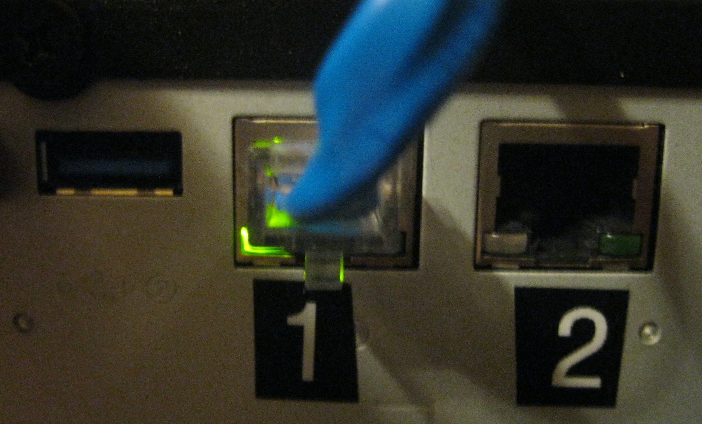

The back of the unit still appears as this, the only LED on the NIC’s is the first left-hand one.
It is connected in to a SWITCH on the same network as my PC.
My existing router/network are 10.0.0.x based.
If I unplug the DX4000 and put it onto the isolated 192.168.0.x based network, the LED light status does not change.

I pulled the cable away for a good pic of the lights. :grinning: But I’ve already swapped with 4 other cables, all of which are working and connect fine for other devices.
