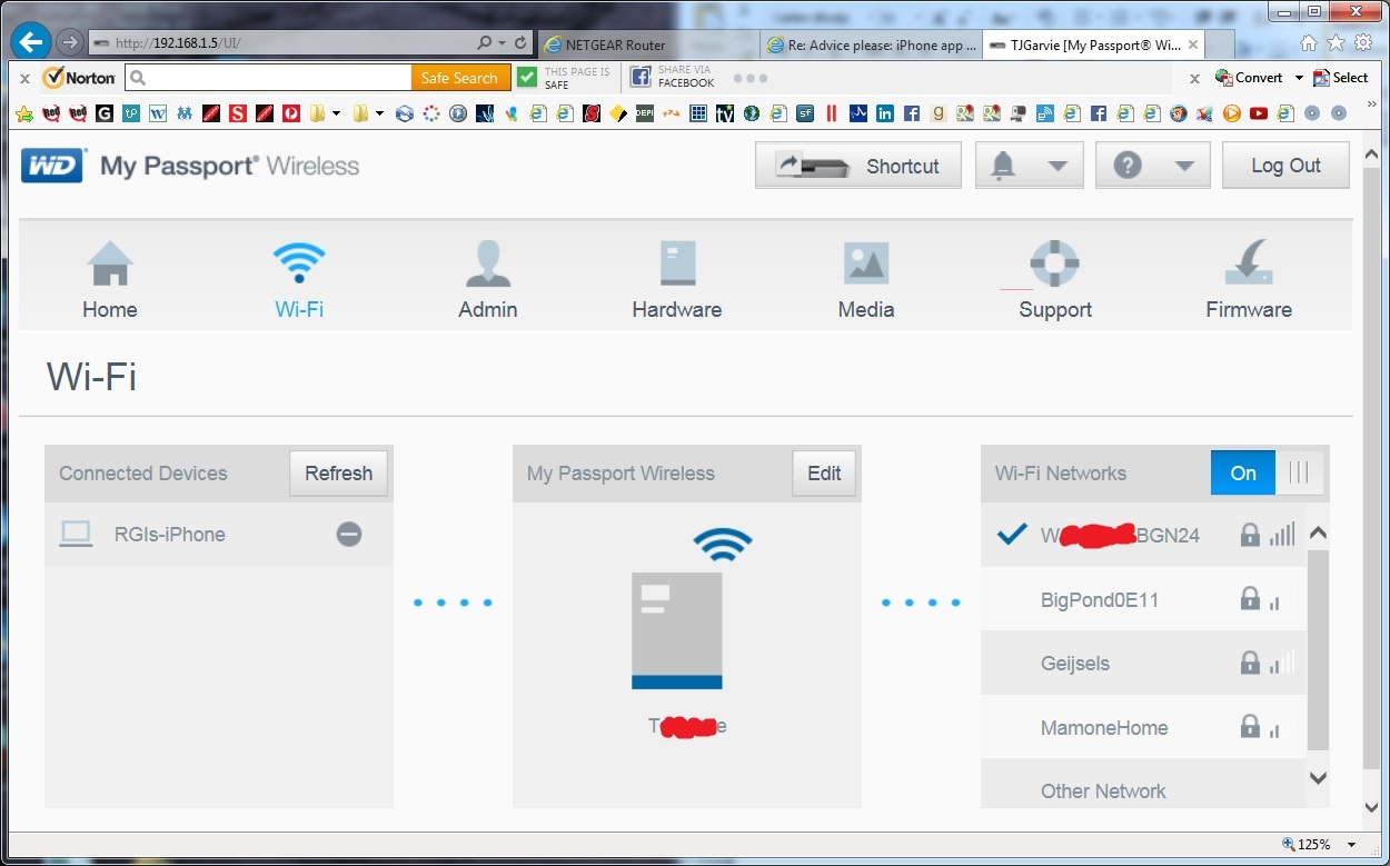

Just for reference, this is what the Dashbaord looks like when my iPhone 4 is connected to the MPW, which is then connected to my Wireless Home Network.
