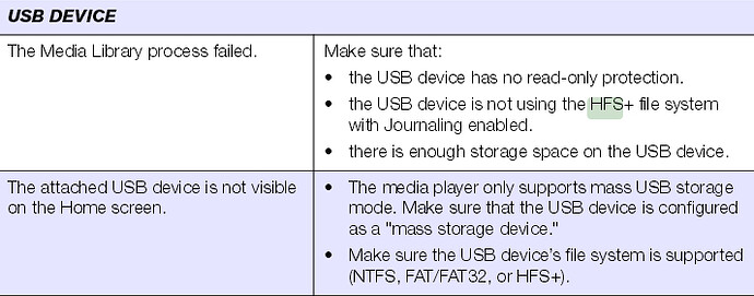

I’m not a Mac person … but reading the User Manual on page 214
Media Library fails if you have Journaling Enabled [see below how to disable it]

http://support.wdc.com/KnowledgeBase/answer.aspx?ID=2615
