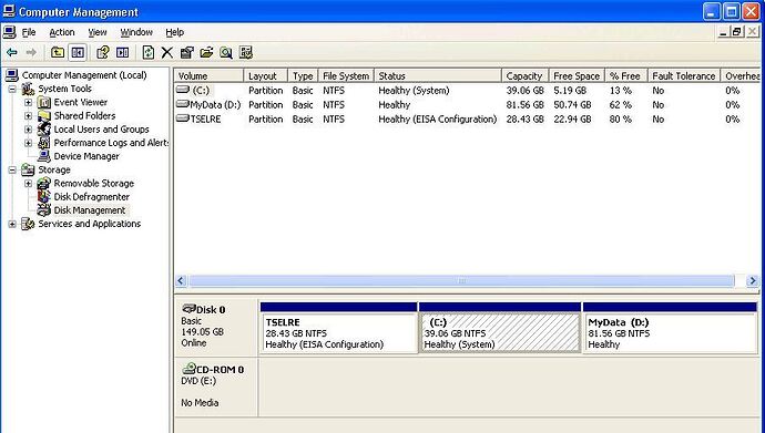

on “MY COMPUTER” : NOT THERE / NOT DETECTED
on “DISK MANAGEMENT”:
on “DEVICE MANAGER” :
