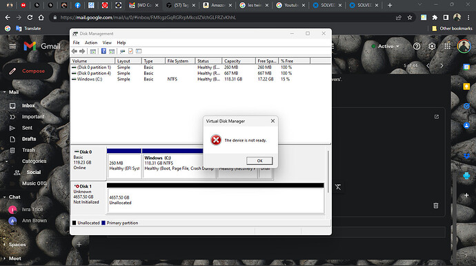

I purchased a 5TB WD Elements external Hard drive from Best Buy the same time I purchased my laptop. The external drive working all good until 2 weeks ago. It’s not being read by my pc, it lights up, shows some sort of error in disk management too. I do not travel with this drive, it stays at home along with my Windows 11 Laptop. I travel with a Chromebook, never leave home with out it. I recently early retired from the food service indusrty. I needed a hobby other than reading. Purchased Podcast software, I purchased a Drone. I purchases a DJ Controller. I PURCHASED ALL THE SOFTWARE to enjoy my early retirement and STORED it on a WD 5TB External Hard Drive. OBS Studio, Searato DJ Pro 2.0 AND 3.0. CorelDRAW 2023 SUITE. Serato Studio… Manuals for all these software…to sit back and take MY TIME to learn and enjoy. Yeah, WD Elements E5TB xternal Hard Drive told me to stick it where the sun does not shine. Well over $3,100 in software down the drain on a $119 external hard drive. I’m mad as hell. What do I do? I mean is anyone going to read this and help me? I have never felt so bad before in my life.
please tell us a bit more about the error you are receiving in disk management.

No, it has been setting on the counter next to my laptop. Laptop doesn’t move, I leave it setting on the counter. This is the 2nd time with a WD Element I have lat all my data on it. I’m going to see if I can order the connecting cable from Amazon, it’s 3.0 and see if that the problem.

I have a PS4 that has a 2TB Drive that I also purchased a couple of days afterwards. It uses the same type of cable attachment, so I switched it out, the 2 TB cable with the 5TB Drive. The Drive lights up, but doesn’t register in My Computer. So, I figure the Drive is Shot. The 2TB drive has a PS Logo on it, can’t tell the make or model though.
