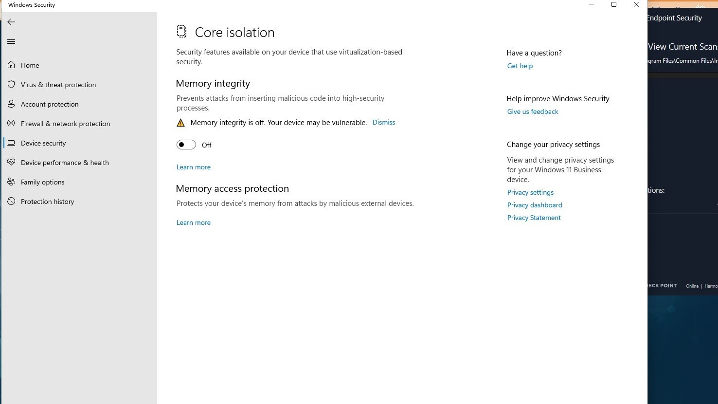

I have a computer with Windows 11 Business v. 10.0.22000 Build 22000, I am using a 4Tb My Passport external HD to save my files.
Today I found out that a vulnerability in an driver is causing my computer to be susceptible to malicious code to be inserted into high-security processes. I have been seeking for an official solution from Western Digital and looks like there is no even a word.
I tried to Safe Mode to delete that drivers and toss away my My Passport external hard drive, but I could not even un install it. I tried the update, nothing. Tried drivers and nothing.
I wonder why Western Digital is not releasing an official solutions to a SVC level 10 vulnerability.

I have the same problem, which was first noticed when the Windows Security app reported that Memory Integrity must be switched off because of this driver. The app does not tell with what device the driver is associated.
