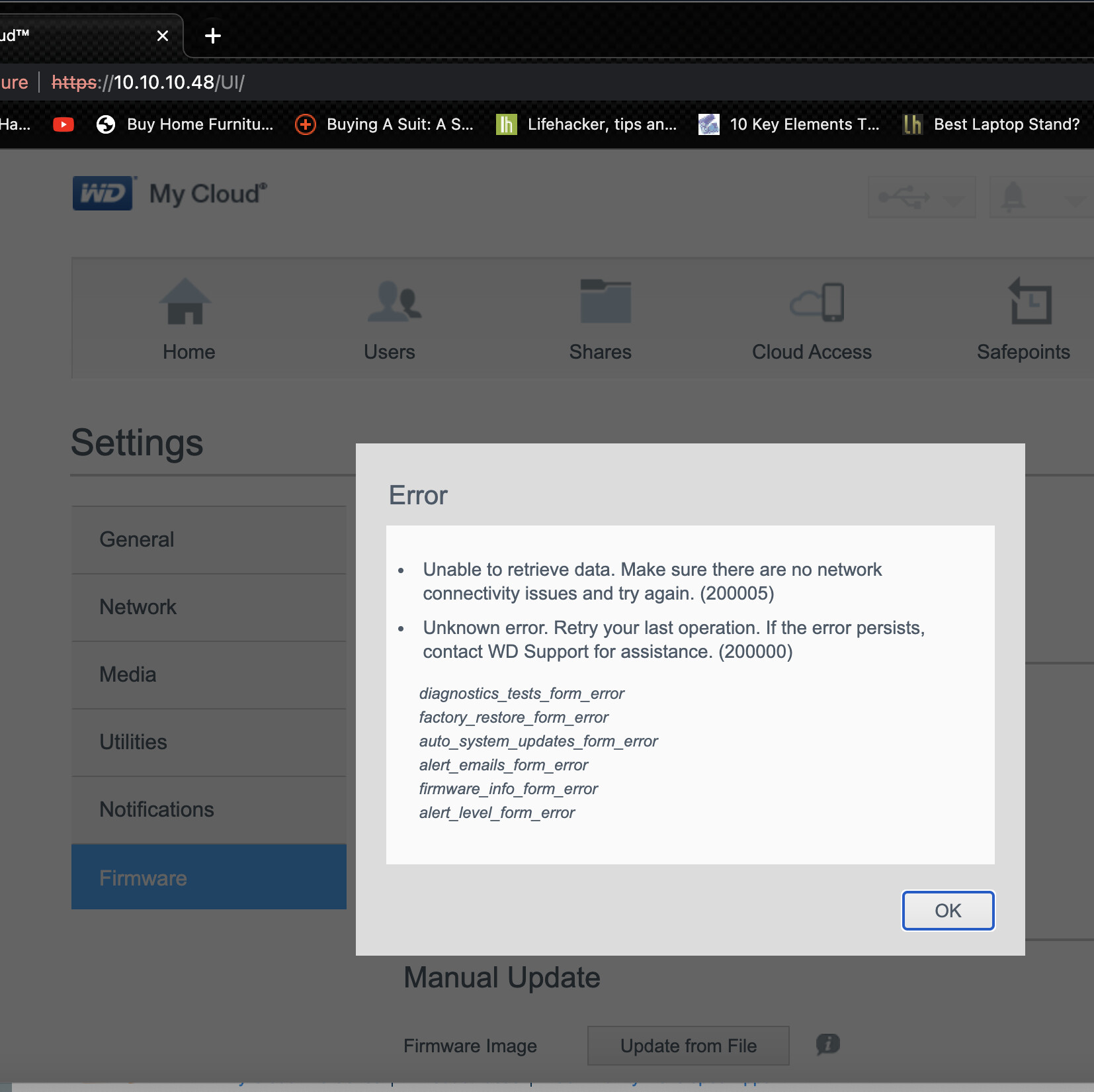

Trying to upgrade to OS 5 but experiencing major issues
I have a WD My Cloud which I was using up until a few days ago. I was trying to run time machine backups on to it but it was not working so I thought maybe the firmware needed to be upgraded.
Accessing the Web UI with my admin password was problematic so I was forced to reset the device today and now the device is no longer showing disk space usage. It had some tasks for scanning media which were cancelled so now I can’t see what is on the hard drive.
I have done a hard reset and also a system reset but nothing is working properly anymore.
I also tried manually upgrading the firmware to OS 5 and its giving me a message that there is not enough disk space to complete the upgrade.
Can anyone explain what’s happening here?
When you say you did a “hard reset” what do you mean? Reboot? 5 sec reset? 40 sec reset?
What is the My Cloud’s part number (its on the bottom). If it ends in -00 it’s a first gen model and can’t be upgraded to OS5.
First, the first generation single bay My Cloud running v4.x firmware cannot be updated to OS5 v5.x firmware. The v4.x firmware cannot be updated to the 2.41.116 (12/08/2020) second gen single bay My Cloud firmware that is needed to update to OS5 v5.x firmware. Your screen capture, indicated by the Safepoint tab, indicates you have a first gen single bay My Cloud running the v4.x firmware.
