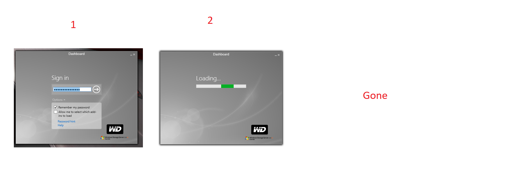

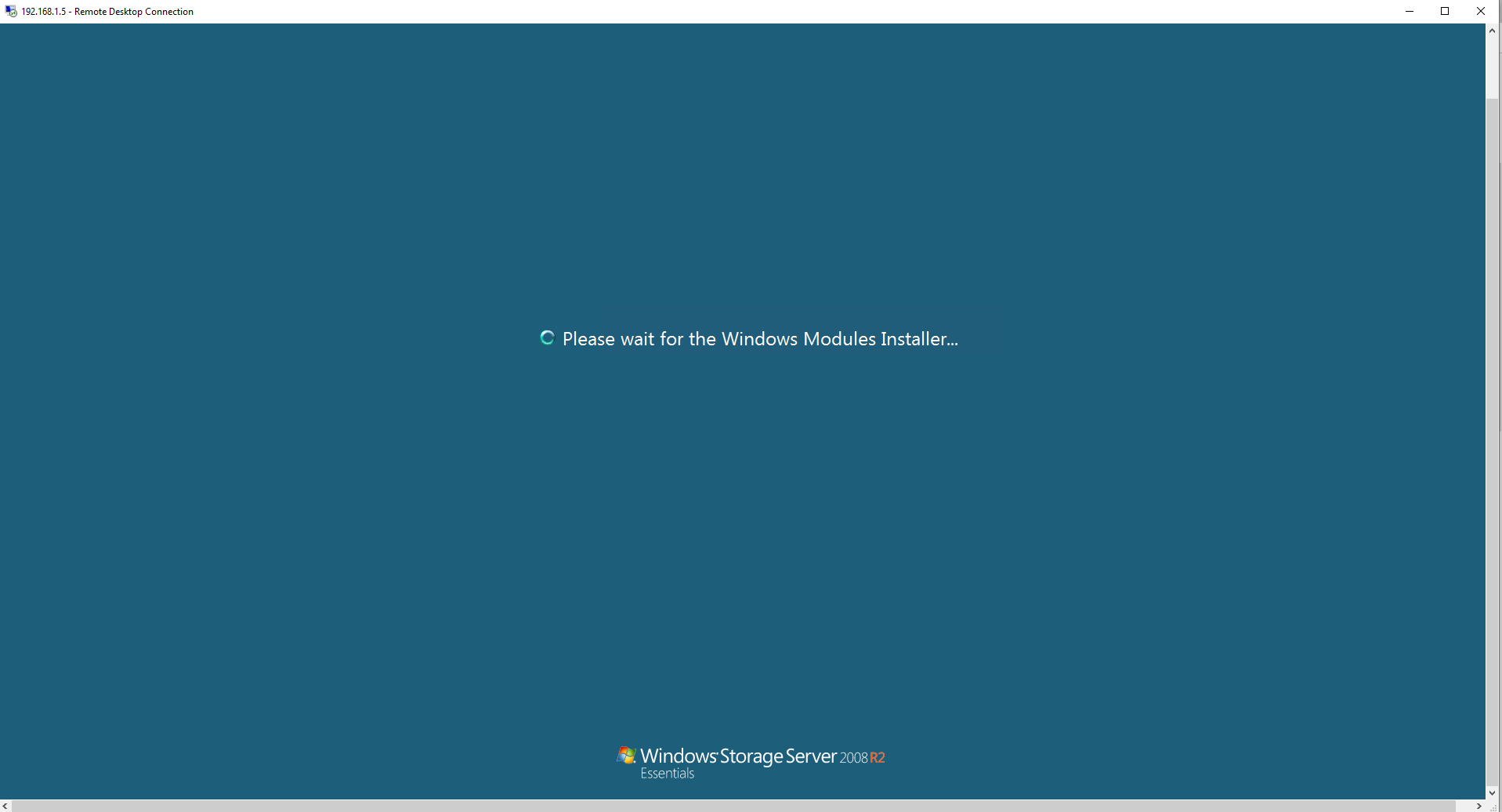

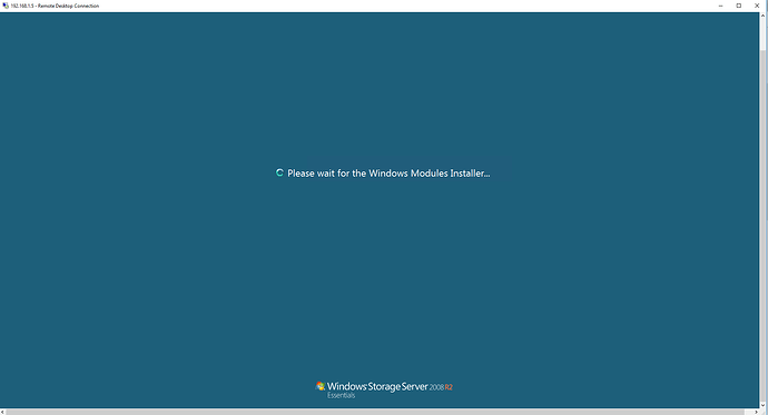

BUT I can’t connect to the sentinel via the Dashboard. It starts loading but just disappears after 30 - 60 seconds (I’ve never seen anything like it). If I connect via Remote Desktop Connection, I get all the way there but it just says “Please wait for the Windows Modules Installer”. It does not show the remote desktop, just stuck on that message on screen.
I can reach the folders and the files on the Sentinel via the network with file explorer but that’s it.
So we go from one issue to another, sigh. Any thoughts of what I can do now?
I ostensibly can not control the Sentinel. Is it possible to do a “hard reboot” with the power button on the front panel? How do I get the “Windows Modules Installer” to load, so I can get into the server? I can’t access anything to restart it or control it in any way now.
Remote Desktop Connection:
Dashboard:

Google says just wait. One person said 2 hours another 10
Waiting over night seemed to have done the trick. I could both open Dashboard and remote desktop connection this afternoon. I just did a rebooting again to confirm that I don’t have to wait as long to reboot next time and it rebooted just fine. It’s all running smooth again now. Sometimes for these Sentinels it seems like time and patience is the best remedy . Thanks for the help guys. Much appreciated.

Interstingly enough on one of my old WD Sentinel 4000 units I am now using just for backup purposes reports this message “Please wait for the windows modules installer” when connecting with Remote Desktop. Ctrl Alt Home does not seem to work, is there any other way besides Remote Desktop to gain some control of the Sentinel? Everything looks working in terms of server functionality but there is no way to access it.
ctrl alt end is the remote desktop version not home
yes, my mistake when writing, I meant ctrl alt end (which did not work when the message “please wait…” was shown). I left the WD4000 switched on and after a few hours the desktop appeared and everything was working again nominally, strange
