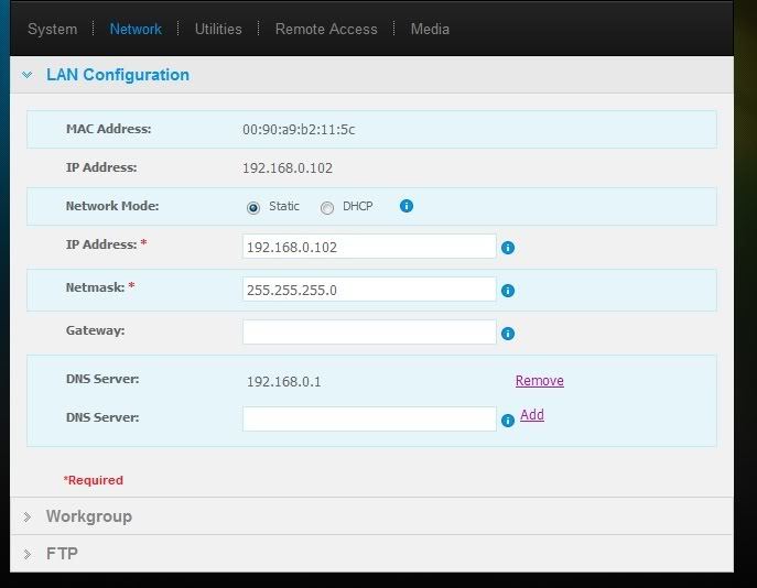

First I created a static IP in the mybook live:

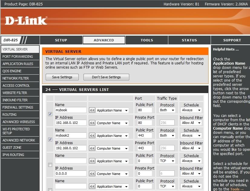

Then I set that IP address and the ports you mentioned in my dlink 825 router:
http://i70.photobucket.com/albums/i105/chrisis1033/router1.jpg

I think you have this setup wrong.
The DNS server you are specifying is likely your gateway. You should change the gateway to be 192.168.0.1
The DNS servers will be reported by your router. They do not start with 192 IP addresses. If you cannot find them, you can use google’s free DNS server addresses : 8.8.8.8 and 8.8.4.4
On your router setup, try setting the protocol to “both”.

This is the current static setup for the mybook

This is the change I made to the virtual server ports on the router (changed to BOTH as you suggested)
