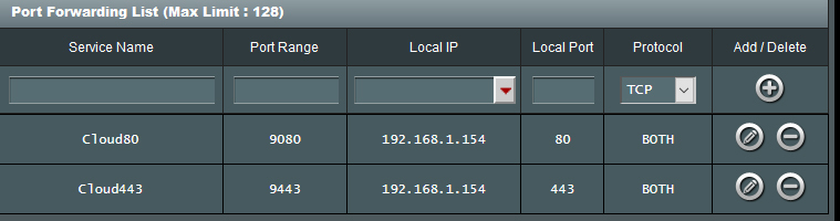

Here are the settings on the MyCloud…
Setting the access ports on the MyCloud to 80 and 443.
This is the rules on my router to port forward incoming connections on port 9080 to 80 on the mycloud and incoming connections on port 9443 to 443 on the mycloud.
This is the result on the status page of the mycloud.
Showing the direct connection estrablished.
Using those port forwarding rules means that ‘Auto’ works just as well also , but I like to know and be more in control of what’s happening.
