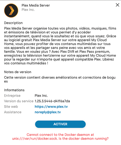

Since the last update, there is a connection problem to Plex. Everyday. Sometimes, rebooting WD Home is helping, sometimes not. I had to uninstall Plex and reinstall it completely. here is the screenshot of the error message :
