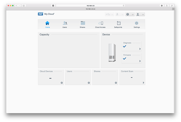

I recently updated my firmware to 4 and since then the web interface has stopped working. The myCloud turns on with a white blinking light and it can be pinged and if you open the web interface then it says ‘device initializing’. After that the light turns to solid blue and all the shares start working, the ssh works as well but the web interface just says ‘Failed to open page, server not responding’. I’ve tried reseting it using the button a few times and i’ve left it on for hours but no progress. The light stays solid blue, everything else works besides the web interface. Any ideas ?
Is this happening with different Internet Browsers as well?
Yes all internet browsers and from multiple computers. While the LED is white and blinking the web interface opens up but is really slow, same with the shared folders. Sometimes i can use the web interface for a few minutes even though its slow but as soon as the LED turns blue, the web interface just turns off. There is no loading of the web interface once the led is blue, it just instantly says site not available.
It sort of feels like the web interface just turns off somehow as soon as the HDD is fully on. Maybe there is a way to turn it back on or restart it using SSH ?
So I did ‘/etc/init.d/apache2 restart’ and i started getting the web interface again but it doesn’t look usable. There aren’t any options and you can’t update anything. Its just the UI that does nothing.

So I tried all of it and the result was exactly the same. It worked fine with previous firmware, I did a quick restore and it was showing the correct disk space and everything but as soon as I updated firmware the web UI just completely stopped working. Any suggestions ?

So I did all of it again including the format, same result. Then i only did step 16 (15 doesn’t work for me everytime) and now it started working again back from firmware version 3. Maybe I should look into the apache logs but I’m not exactly sure what to look for.
