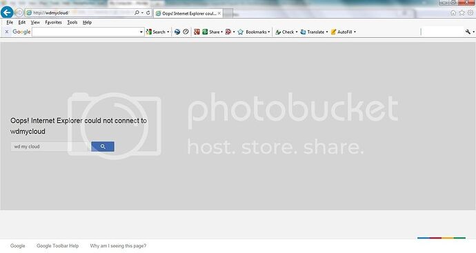

Error
• Timeout; waiting for reboot. Verify that the LED on the front of your device is not red; then find the device on the network and reinitialize the web user interface. If the LED is red, reboot your drive manually. (31001)
Reloaded web page (http://wdmycloud/) and Dashboard fails to load.

Problem remains!!! Dashboard fails to load, while the My Cloud can still be accessed via Windows Explorer and DLNA media player clients, and Twonky administration page is accessible.
