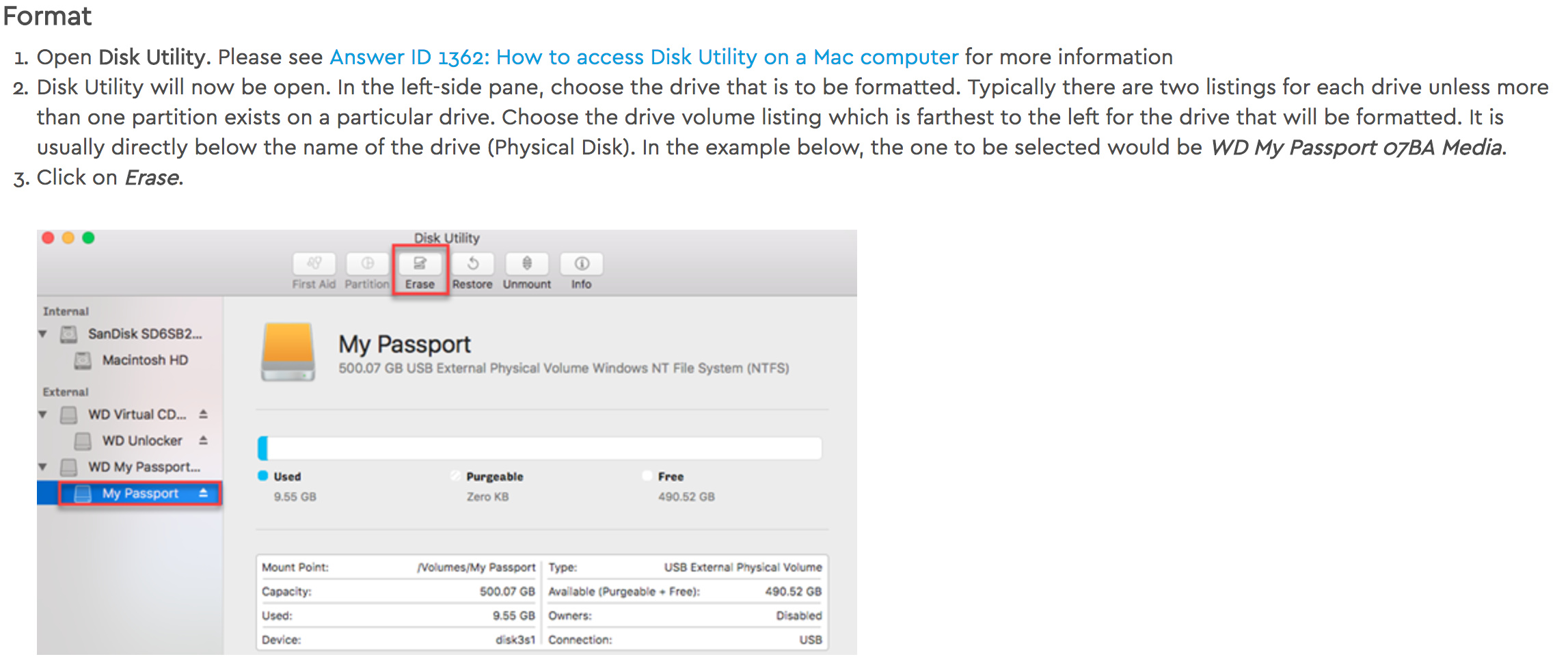

After I successfully reformatted the drive, I went and rechecked the instructions:
Step 2 is what got me. It did say the one farthest to the left, and it named the drive “WD My Passport ____ Media” which, in the end, was the correct one to erase. The pictures stated otherwise. It was a confusing mess in my head, and I suppose I should have tried that before coming here.
Thanks for the help!
