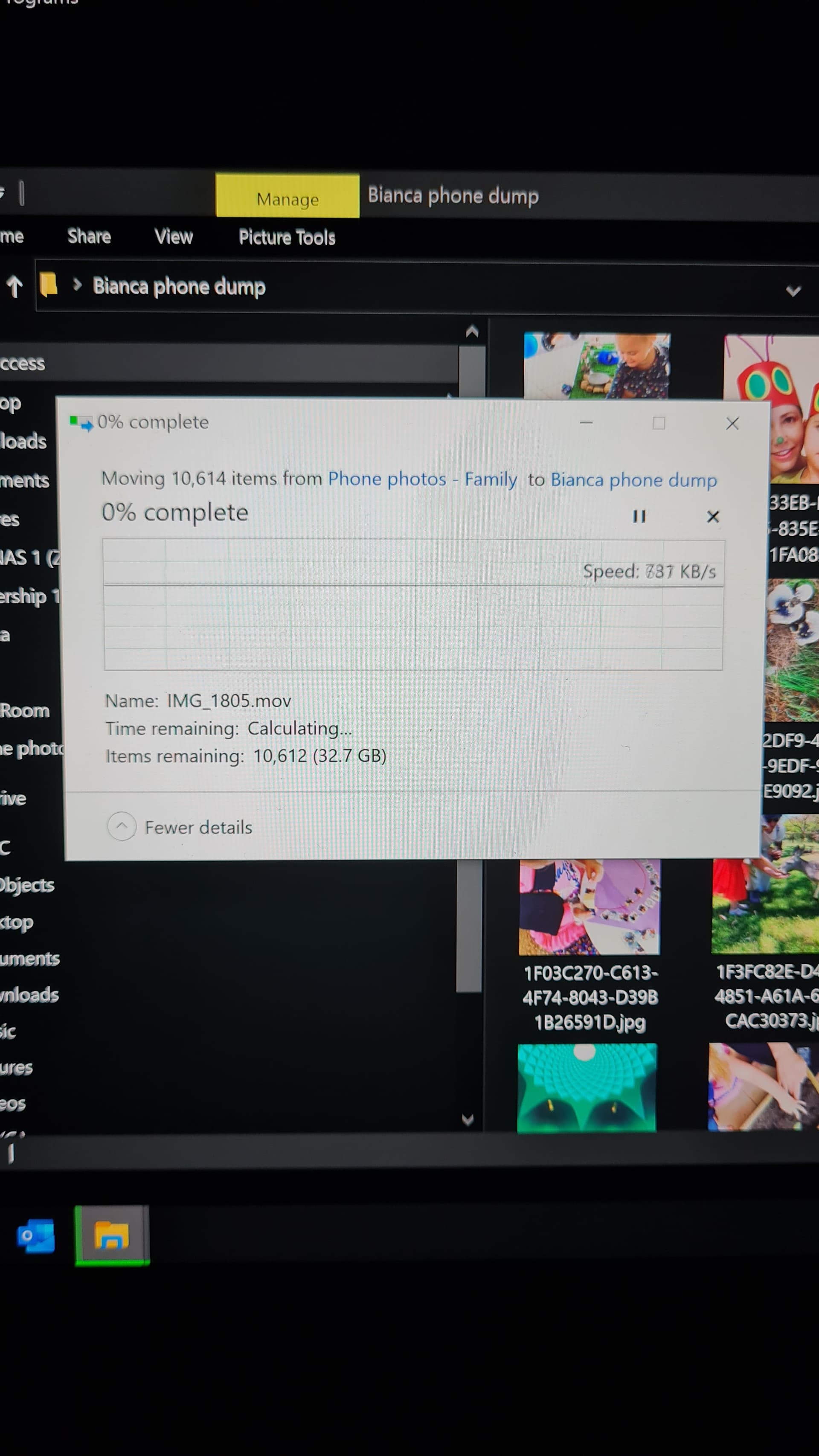

I am trying to move files internally on the drive. It is terribly slow using Windows file explorer and and it doesn’t change whether im on local, direct, proxy etc
I get the same speeds as above regardless of connection and the web based page is terrible to use!
Even uploading stuff is 30mb max…can any1 help? Im so close to spending a day downloading all my data and throwing this in the bin…
I should also add…deleting files takes just as long…
Yes, unfortunately i dont yave that kinda cash, its ok transferring from usb to it, but actually doing anything else is the worst thing I’ve ever bought

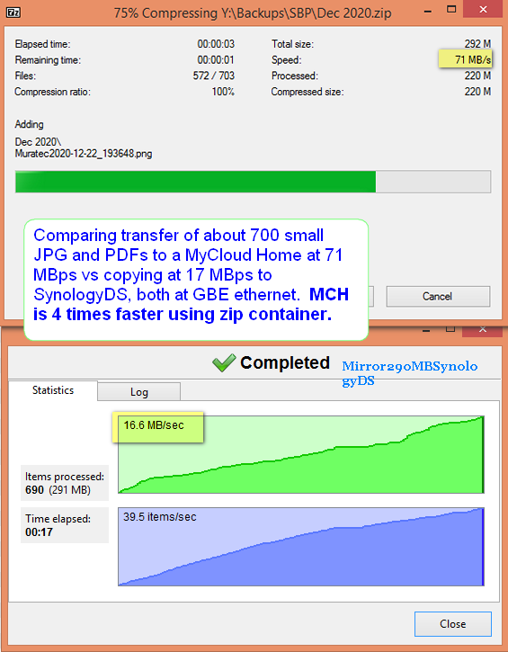

With a little planning, you can store small files into zip containers on the My Cloud Home and copy or move the zip files at up to 76 MBps, about 100x faster than copying and storing small files. The zip containers can also be mounted and files within browsed using many free zip-mounting file systems.
Got a new pb. I cant zip them on file explorer as it crashes…and then trying to select all my photos for download is impossible as Chrome crashes after scrolling to the 3k mark… that 700kb is the pb…it goes back to 0 for a while, then spikes to 700kb…this nas is a peice of ■■■■ and i want my money back. Wonder if i can pull the hdd out of it and put it in a synology one
I am not going to defend the architecture of the My Cloud Home and some of the software decisions, but the hardware itself is solid (better than the DS120j) for the most part and if you know the limitations, it is a good personal storage unit. If you could return it, by all means return it and try something else. If you know how to manage your files, you will get 4 times faster transfer speed with small files from the MCH than using the SynologyDS; I know because I have both of them on my network. The weakness of the file system on the MCH is that it is slow copying, deleting or compressing thousands of small files such as JPGs on the MCH with file explorer. You can overcome this weakness with the specific software as detailed above.

Yes, a USB 3.0 drive is a good alternative if one is available but you have to consider the amount of time it takes to copy the files to the USB drive in the first place. But it never hurts to have an extra copy of data on a backup USB drive. The MCH USB 3.0 is capable of 130 MB/s speed but could only be controlled from the Web or mobile app.
Yeah, a usb drive is how i get mine on there too…but its once they are on there is the issue…even trying to move what folder they are in is an effort…im trying to delete 32gb atm…its been going for 12 hours…its a task to use the web browser as it only loads 100 photos at a time…by the time i get 3k to load, the web browser crashes.
Terrible peice of kit, which i will not buy another of

Well, when you pay money to get a storage device it should have some obvious capabilities. Slow data transfer rate is not the issue here, it gets stuck at each file. Probably something like looking at all the other files in the folder when deleting one file in that folder or something? If only I could get my money back…
