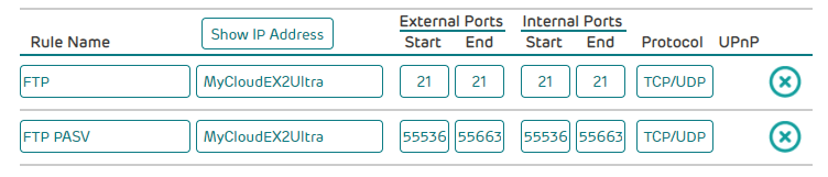

Port Forwarding on the EX2 is configured:
I have configured Port Forwarding on my router to match the above:
When trying to access the FTP folders from a machine outside of my local network, I can access the server, and change to the relevant fileshare, but when running ls or dir, the connection hangs for a long time and eventually disconnects:
