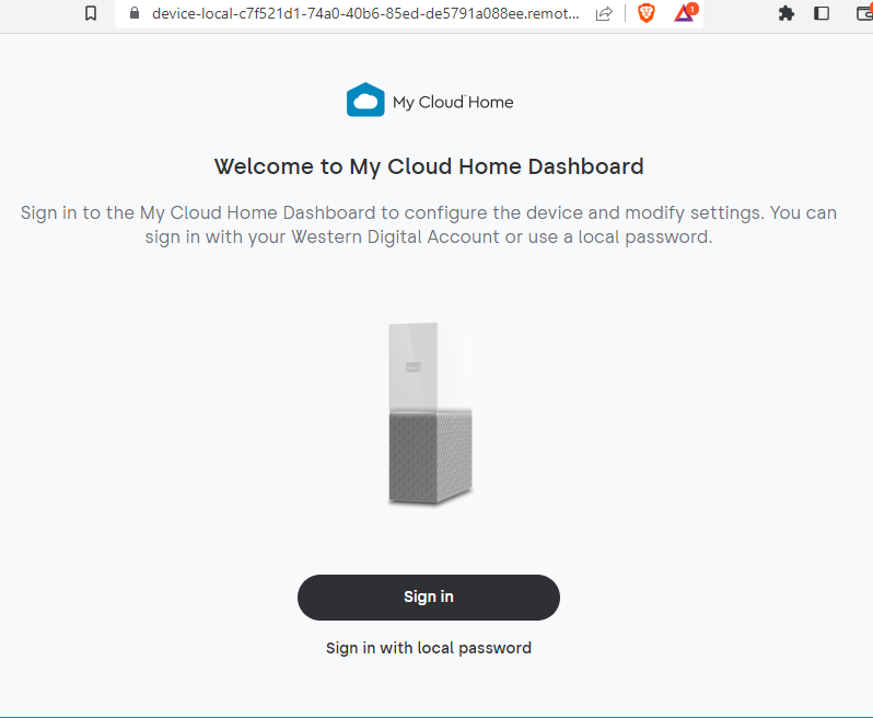

Because WiFi internet is being shared with the My Cloud Home at this point, it is now possible to authenticate with the Western Digital servers and to enable ‘local access’ which is recommended for MCH access without restriction from WD servers.
If a user enters the IP 192.168.137.2 into the Win10 browser, the MCH device-local will show

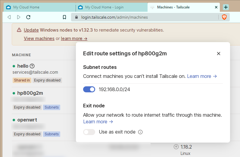

then, go to Tailscale
Enable ICS subnet routing
click Edit Route Setting on that Windows Machine.Turn on the Subnet Route , all done!
