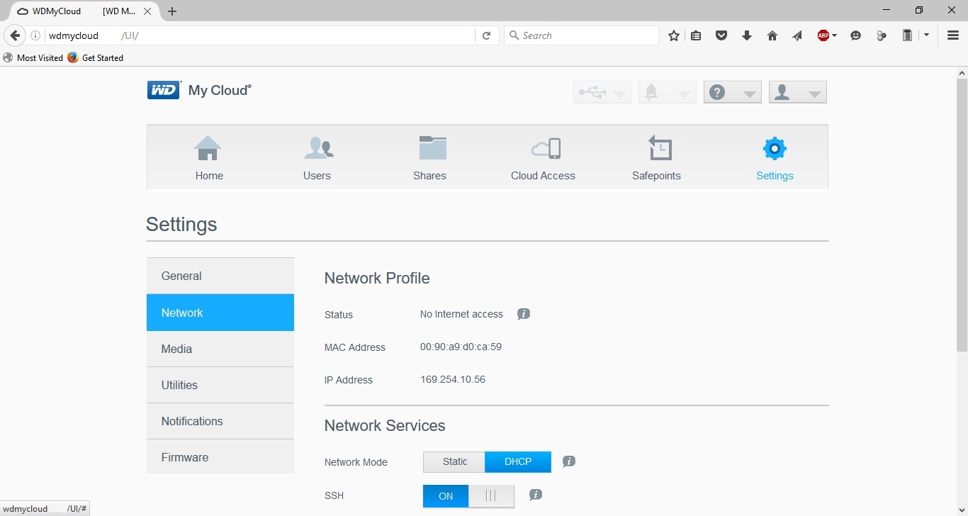

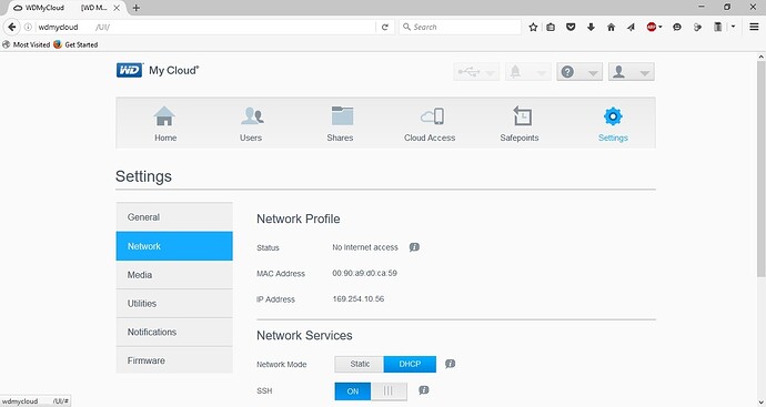

On my Windows 10 PC when the My Cloud is directly connected to the PC the My Cloud auto signed itself an IP Address of 169.254.10.56 and the Windows 10 PC auto assigned itself an IP Address of 169.254.7.203. Both using a subnet mask of 255.255.0.0. The My Cloud shows up when issuing an arp -a command and can be reached via a web browser.
