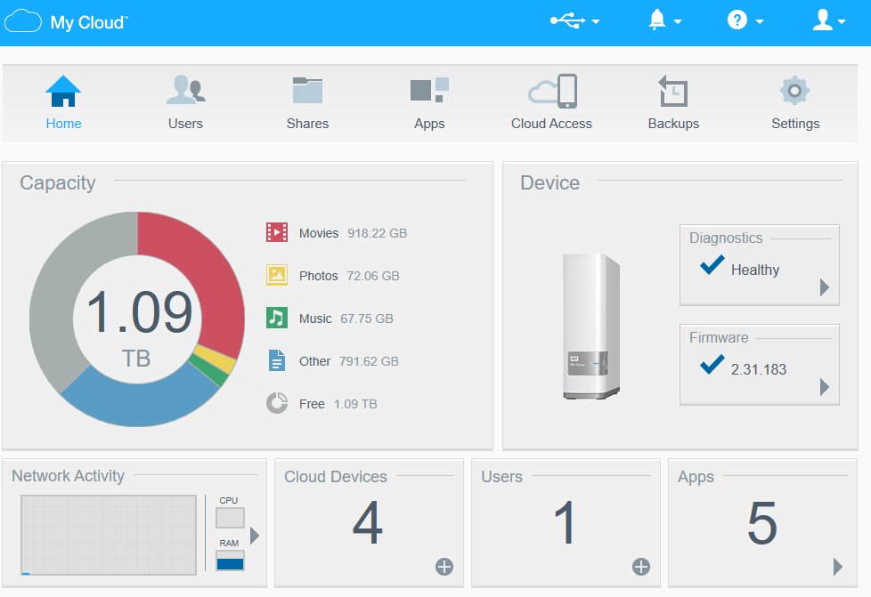

Has this mycloud been hacked
When I log in to admin the nice html home page comes up but before I can interact my session times out.
Login timed out. Please login again.
The home page reports that the system is healthy and that my firmware is version 2.31.183. This is a worry because the latest firmware here is 2.31.174.
All my on board user data is still accessible as is the attached usb drive. A soft reset just deleted my admin password. I’m afraid a hard reset will delete my user logins and effectively brick the thing.

Thanks Tom. I tried chromium which is fast and I can actually get into submenues. Managed to check to see that my public shares were actually public. But the timeout is still way too fast to do anything else useful.
I did manage to check and find that that automatic firmware update is turned off. It therefore seems strange that I have the latest version. It updated on Tuesday 4th June 2019 at 10:00.28. I was at work then.

Having previously carried out both soft and hard reset procedures with the button on the back I was wondering what else to try. Here is what fixed the problem. I don’t know if this is relevant but I unplugged my usb drive before starting this process… Starting at the main admin homepage I Selected:
Settings > Utilities > Device Maintenance > Reboot.
Upon my return I was put through the startup wizard. It didn’t perform quite as expected but there were no timeout problems with it. Back at the home page I soon realised that my timeout problem was gone. BUT My users and self created shares had all disappeared. Everything in the /Public folders was still there.
Being optimistic I created a new share with the same name as the old one and to my surprise all my files were still there.
Recreating the users was easy enough.
I hope someone finds some use for this information.
