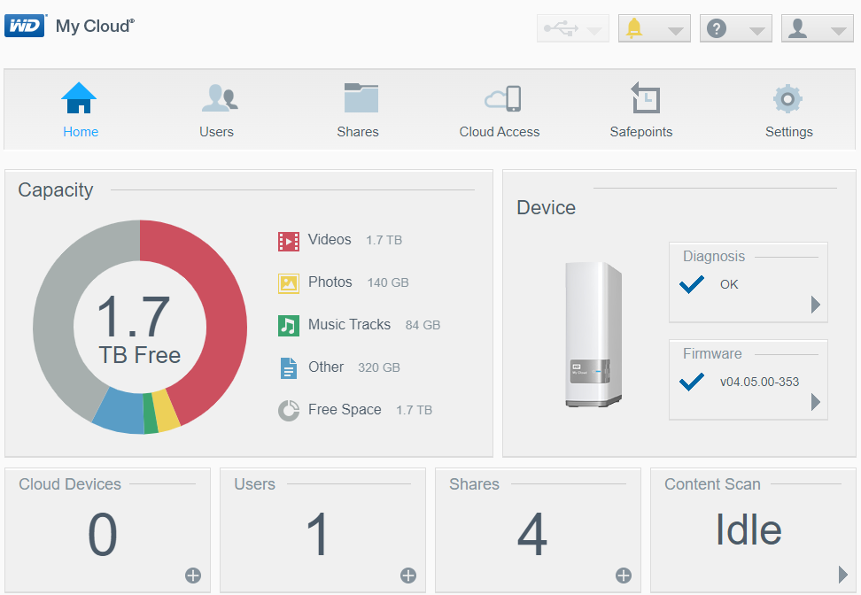

Are you able to provide an image of what you are seeing? Below image is from my four TB 1st generation My Cloud Dashboard.
