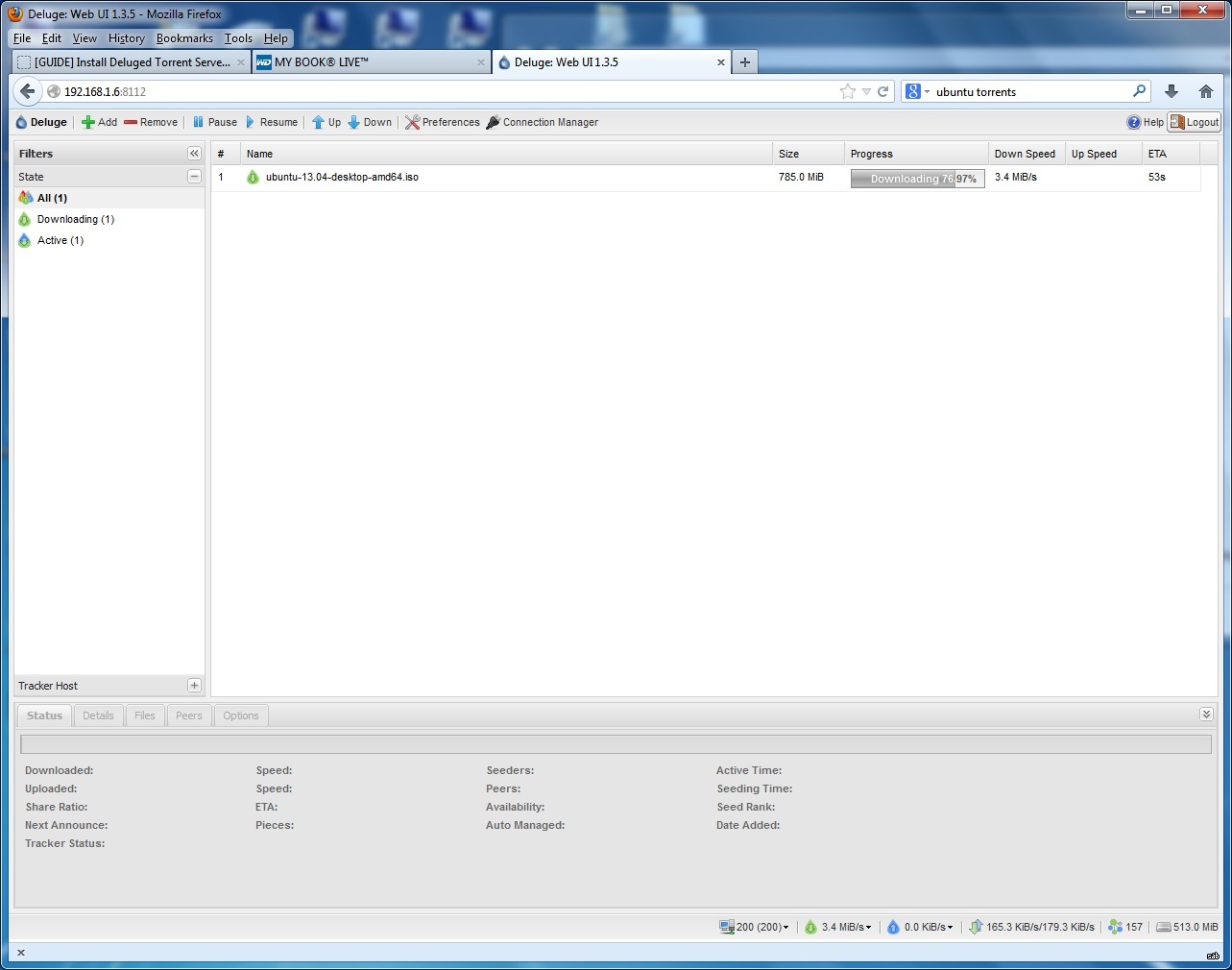

In your web-browser let’s connect to the web-ui
http://your MBL name or IP:8112
password= deluge
Connection Manager will now pop up
Select the server and hit connect
When asked, change the password and hit the Change button
Go to preferences and make any changes you need starting with download paths

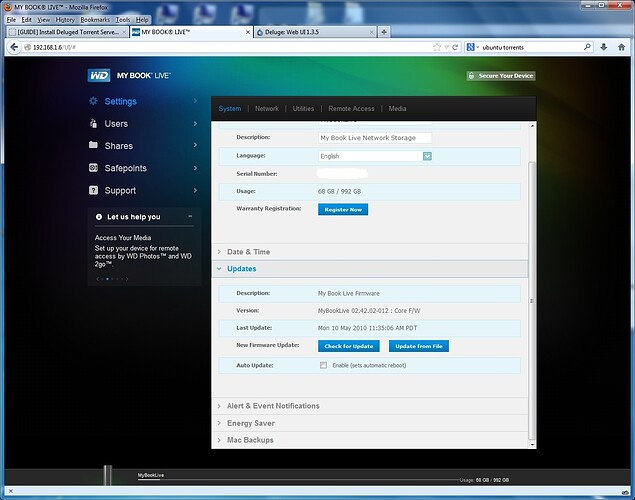

I have managed to get everything upgraded to 1.3.5 so that magnet links are working and have modified the guide accordingly

I did everything on it, and I ran into two issues.
The first one would be that I cannot access my MBL dashboard anymore… This is not a big trouble for now, cause i can still access my shares on all my devices… Though I think it will be a bit of a deal later.
The second one is torrents wise, when added they just won’t start downloading. I’m smelling a router problem, or a forwarding ports problem.
I wouldn’t know what kind of information would you need to know more about the environment of my problem. please ask me and I will let u guys know more about it.
Well we should start with your dashboard issue as that’s more important than Deluged right now. Use my resetbutton script to get back to a clean OS. Here is the guide…
http://community.wd.com/t5/My-Book-Live/GUIDE-Restore-Downgrade-firmware-via-the-reset-button/m-p/481588
In the meantime I will take another look at the guide and see if I can replicate your issue. What firmware version are you on?
I can’t reproduce your issues, I followed the guide and installed it again on a test MyBookLive and Torrents download fine and the dashboard works great. I even restarted apache just to be sure.
Are you sure you ran this command?
rm -f /var/lib/dpkg/info/wd-nas.*
 Otherwise it’s possible that one of the packages bricked your dashboard

Hi, I decided to use the guide 3 of the downgrade guide but this step confuses me.
5) Copy rootfs.img to the root of your Public folder on the MyBookLive
 Does this mean?
/shares/Public
or
/DataVolume/shares/Public
or these are the same?
Please bare with me and my noobiness
They are the same. You can actually just open the Public share from Windows network and drag and drop it in the folder that way. You don’t need to use WinSCP or similar to do it.
I think your original apt-get install deluge is what bricked you. If I recall correctly, it bricked my dashboard when I installed it that way before I put this guide together.
Ok, downgrade completed. dashboard available now and configured!

The dashboard wants to upgrade the firmware, should i do it? the one that I used with the downgrade.sh was this               ----> http://download.wdc.com/nas/apnc-023205-046-20120910.deb
Yep I would upgrade. You should have no issues :slight_smile:
