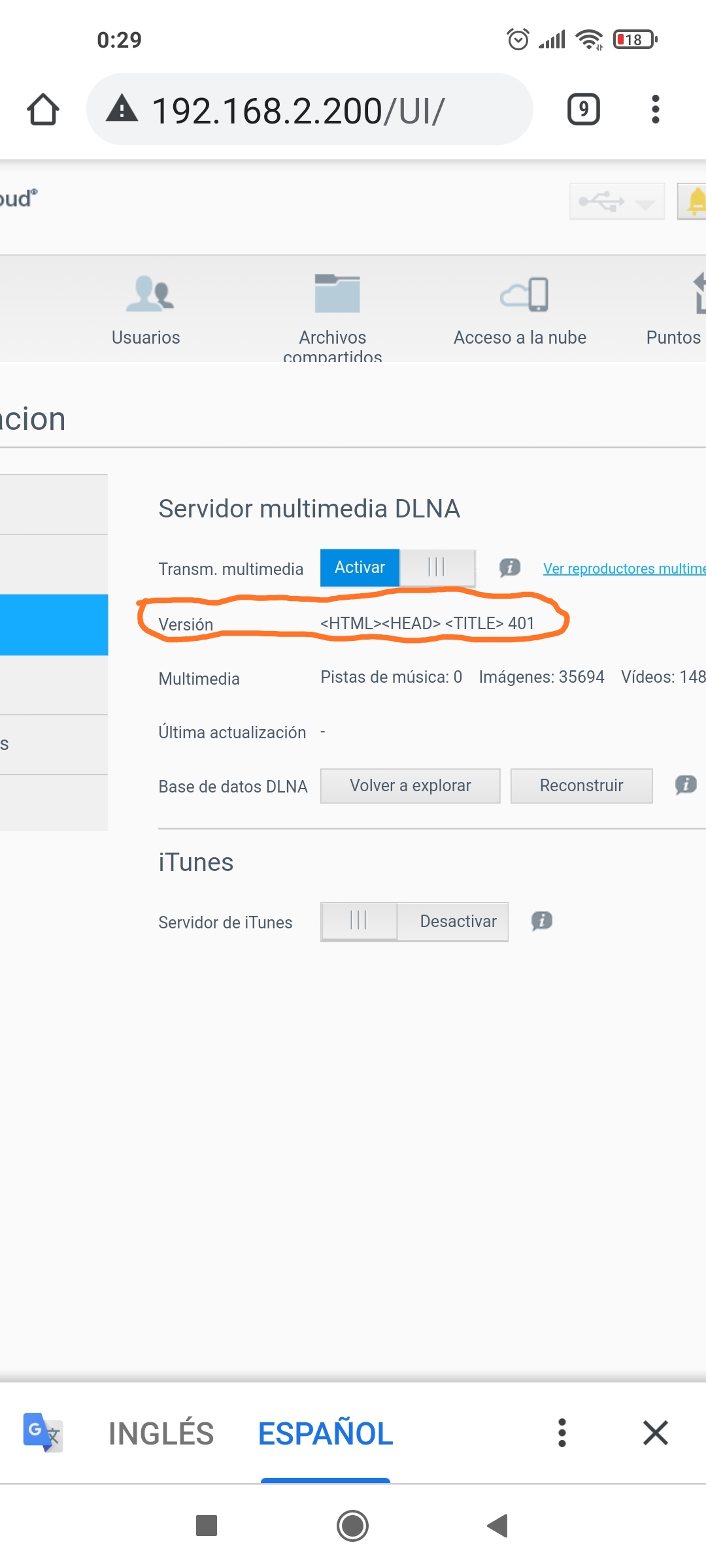

Hi. i have a problem accessing twonky from my cloud. now mr I could username and password and I never configured any private access to it. I have entered the UI of the cloud and I find this in multimedia settings.
How do I solve this problem? do I re-install the firmware manually? thanks

Friend Bennor. The twonky asks me for identification when accessing through port 9000 and I never put that access control. It works apparently well because it shares the videos and photos that I want to share on DLNa, but now I can’t enter it because I have tried various user and password configurations and it gives me an error. observe the screen of access to the twonky server that I put, same problem on phone as on PC.
In the image that I put yesterday of the multimedia menu of the Mycloud UI, a strange text appears where the version of the twonky server should appear.
I’m going to try updating the firmware manually to see if this service recovers. thanks for your help

Generally the only way for Twonky’s administration interface to ask for a username and password is for someone to go in and add a user name and password on the Twonky Advanced Server Settings page. either that or someone gained access to SSH and has changed permission settings at the root level.
Hopefully reinstalling the firmware manually will solve the issue.
Fixed manually reinstalling the current Gen1 firmware of my device. The server has reappeared correctly in its version and no longer asks for username and password. It is the best solution for those who have this same problem. Thank you very much for the help.
