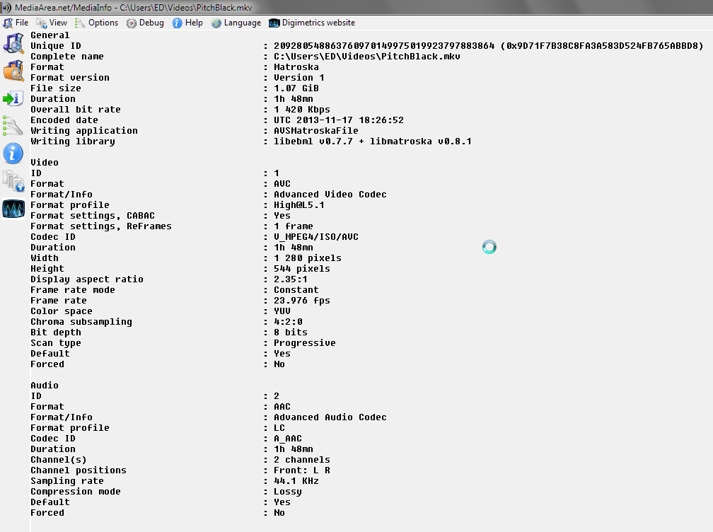

Thanks for the link to Media Info. Nice utility.  I looked at one of the files that refuses to play and it appears to me to match the required specs spelled out in the manual as to what files are supported.

The file type you posted is AVC High@L5.1.
As the specs say, the highest AVC profile supported is High@L4.1.
So it’s not compatible.
So it’s not compatible.> End Quote from above… > OK… then this begs the question why is this spec not supported?. This is not my fault I’m unable to play this or any other current file format.> It;s not goog enough to just walk away and say “So it’s not compatible.”  Am I suppose to dumb down my files to work in your outdated player? So how do I do that?> It appears 5.1 is a more recent spec then why doesn’t WD support it and how much longer before it does? In fact why wouldn’t WD TV Play support all the current specs. given the fact now that it does not?> Also I repeat, your user manual and website is making false and inaccurate claims about what the player supports when clearly you are way out of date in supporting the current specs.> To me, this is not acceptable. For anyone to buy the current playing device, confirm they have the latest firmware and then come to find out you guys (WD) are way behind in upgrades for your device?. I just bought this new, not used. I would at least expect to support the current industry standards.> When will there be current firmware available? This is a disservice to all you customers when not providing support for all the latest standards in place.

Dumb down?   Given the specifications in the mediainfo you posted, you (as the encoder of the video) should never have used L5.1, as the video has NONE of attributes that would have required L5.1 in the first place.
Your video is only 1280x544 resolution.   That’s not even Full HD.  The bit rate is only 1.5 Mbit/second.  Given that, your video should have been encoded at L3.1, not L5.1.    It’s only using 1 Reference Frame for crying out loud!  :laughing:
High@L5.1 is intended for videos with resolutions up to 4Kx2K, with bitrates up to 240 MEGAbits per second, and 5 reference frames at max resolution!
So, I would submit that the way you’re encoding your videos, it’s already “dumbed down” about as far as it goes.   And changing the profile to match won’t do anything except make the decoder more efficient.

Every file I converted … complied with pages 146 and 147.
You are contradicting yourself.  The file you posted above does not comply with the specifications listed.
