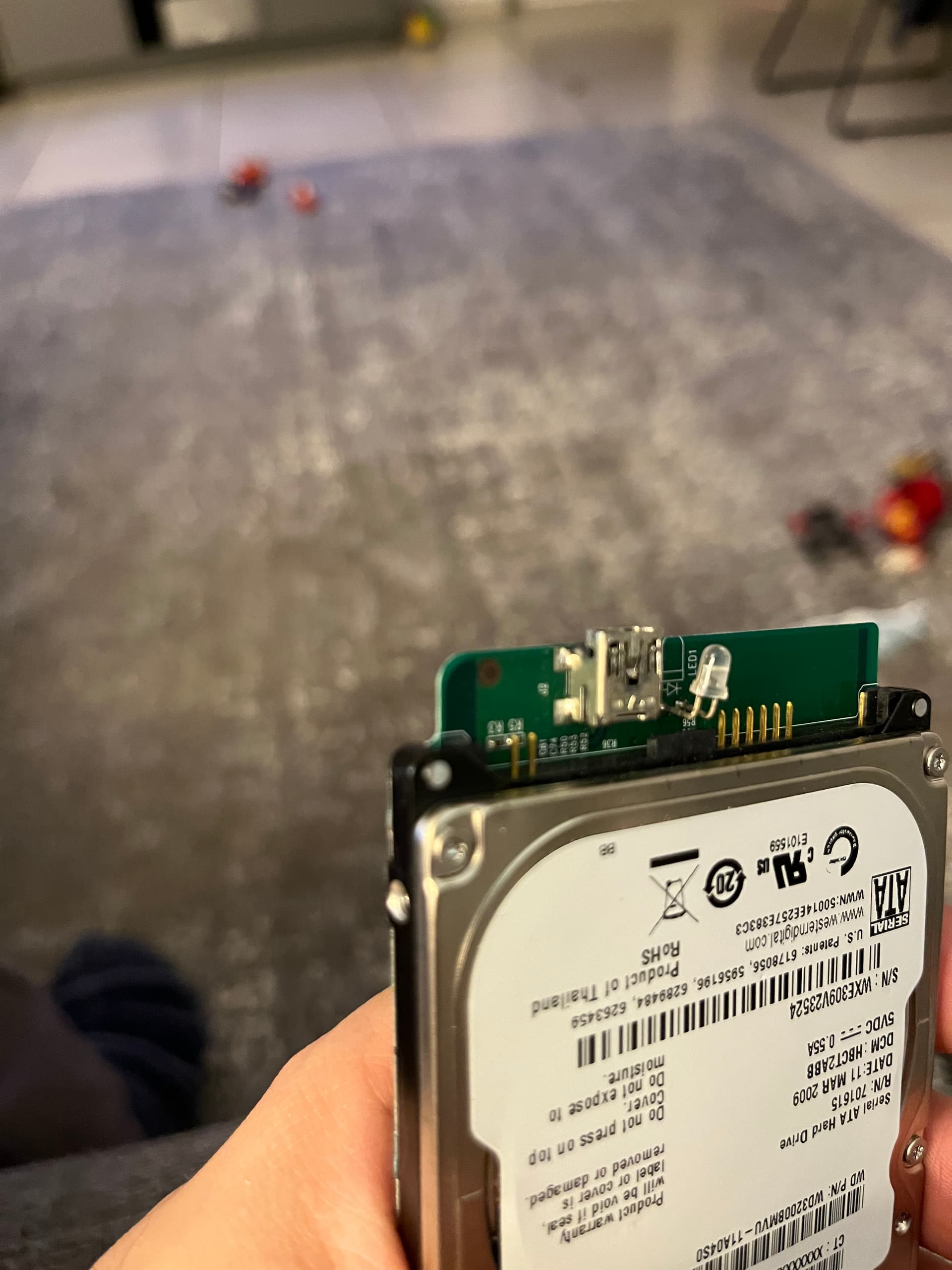

I was soo happy seeing your post. Many thanks. There is just one problem. I removed the cover from the hard drive and it seems that I have a slighty newer version. The USB port seems to be on the board.
I have another WD Driver with Micro USB. Maybe if I buy an adapter to Mini USB?
Or are all USB sync cables the same apin configuration and I can another one?
