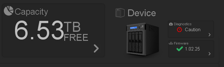

This is on my dashboard…
It appears that I have my volumes mounted given that the dashboard is reporting capacity of both volumes, but on the storage page…
So there seems to be a disconnect between what is reported on the dashboard and what is shown on the storage page.
I ran into this discrepancy just trying to determine the behavior of this NAS in degraded mode.  I removed one of the drives on my second volume (in RAID 1) while the volume was mounted.  As expected, it is now in degraded mode and rebuilding after the same drive was replaced.  It thought that rebuilding a RAID1 configuration would be faster than, say, RAID 5.  Maybe it is, but it still it appears to take over 10 hours, and the estimated time keep increasing, not decreasing.  Of course, the important time is the actual time it takes.  I can use the degraded volume while it is rebuilding, though.
