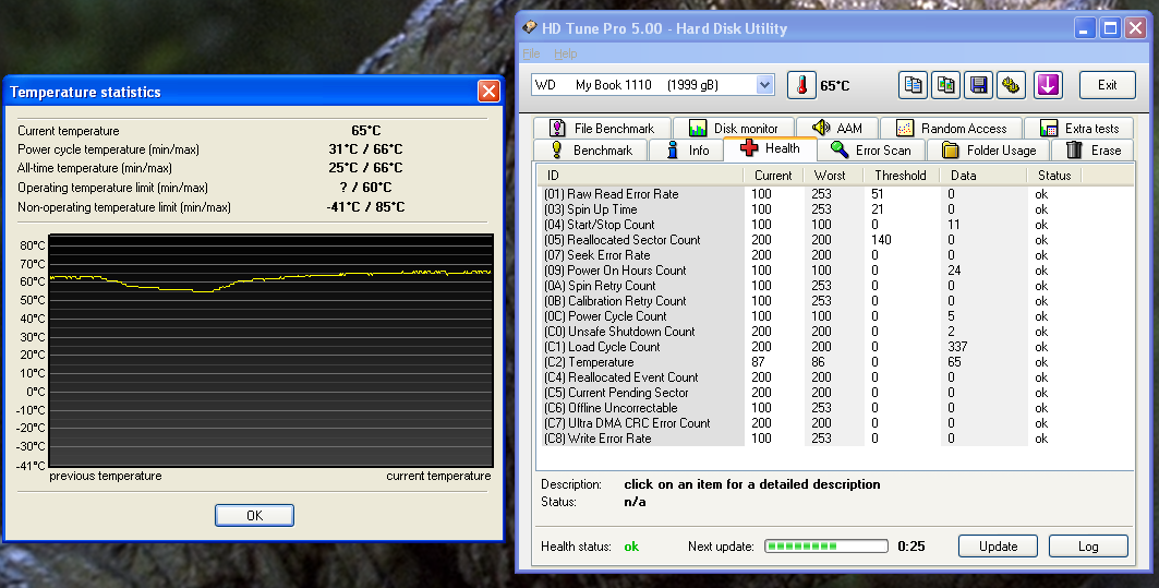

Very bad surprise, it’s nearly as hot as the WD Elements when I transfer my files. about 63°C yesterday, today up to 66°C… The WD Elements Desktop is 68°C. My samsung in the PC is 33°C. Temperature in the room : 25-28°C.
I don’t know what to think at all… It would be very unlucky to receive 2 defective disks. And on the other side I have many other drives and they’re not so hot.
I tried many software, they all give the sames temperatures (everest ultimate, HWMonitor, HDTune pro). And when Itouch cases it’s hot of course^^
Here is a photo of the Drives :
And 2 captures of HDTune Pro with the temperature of the MyBook yesterday and today (in use) :
Could anyone give what temperature display his WD External Drives please ?

SoI tried to pu the drive vertically, after a night off.
It starts at about 38°C. When I don’t use it (no program or transfer or anything), it grows little by little up to about 51°C.
When I copy files (intense session, more the 300GB), it heats up to 62°C. It’s indeed a little less hot than in horizontal position, but still too hot in my mind. I think I’ll try to sell this drive, and buy a Caviar Green in replacement…
