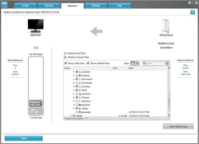

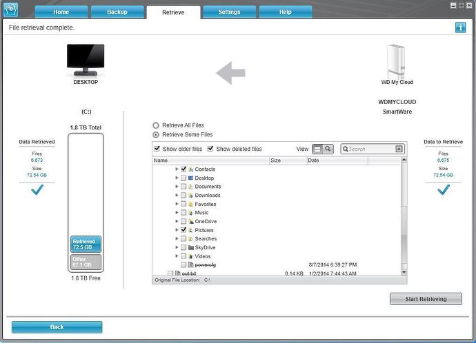

You can retrieve your backups to your computer using SmartWare. Have you looked at this?
