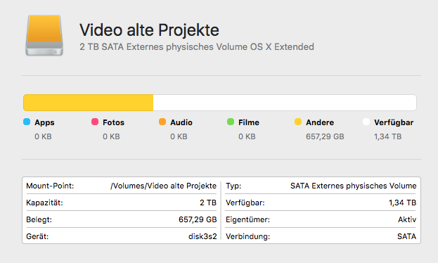

Apple’s Disk Utility does see the volumes. I can activate them, but after a few seconds they will automatically unmount again. Moreover, it says “0 KB available” which is not the case since I know that there is 1.34 TB free space left on that volume (see second screenshot taken after activating the volume).
