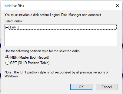

WD My Passport shows unallocated
Hey,
it worked fine for some time and then this :
i’ve got things on it , i don’t want to reinitialise
Thanks for the help :slight_smile:

thats what the Disk Manager says:
Have you tried connecting it to a desktop system backside usb ports?Have you tried changing usb cable?
