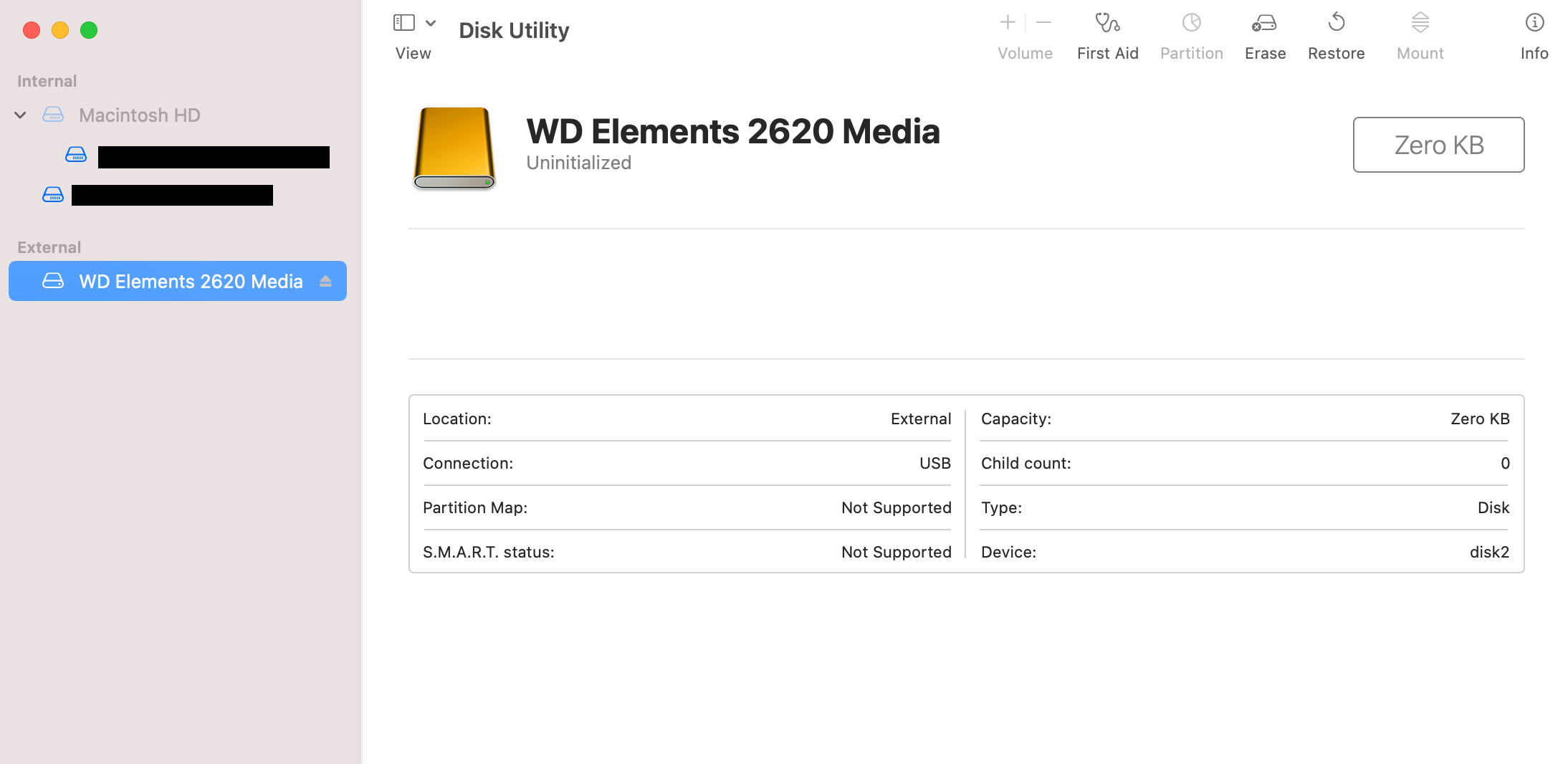

Hi Lizzy1,
Here’s what shows in Disk Mgmt.
When I connect the drive, I hear some clicks, the light comes on to show that it’s receiving power but it doesn’t show up in finder. I clicked on repair and it immediately said it was done but it still doesn’t connect.
Kevin.

The drive is showing 0MB is because the drive is unable to load its firmware, either because of firmware damage, head damage and/or surface damage. If the data is valuable to the user, which is implied in the OP, they had better seek professional data recovery assistance before further damage is caused.

I run a clean room and change heads all day long. It is bad enough to have to tell a person that their data is not recoverable because of an unexpected head crash. But, to have to tell them that it is not recoverable because of the damage caused by the actions they took following the advice of spammers on forums is infuriating.
