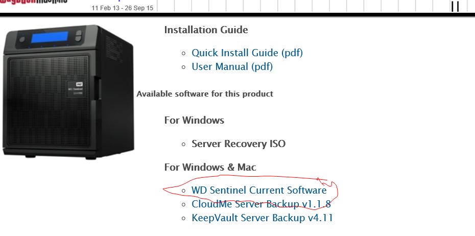

Two things. Using the Windows backup appears not to affect the it’s backup status in the dashboard. I’m not sure which link you are referring to. The ones I tried did not appear to have software updates.
HI, well actually I found that one, but WOW, where do I start?
have to have an older version, just extract that zip and point to it or run setup/install from the zip
actually if you point to it from the dashboard, I think you point to the zip file, not the extracted folder
