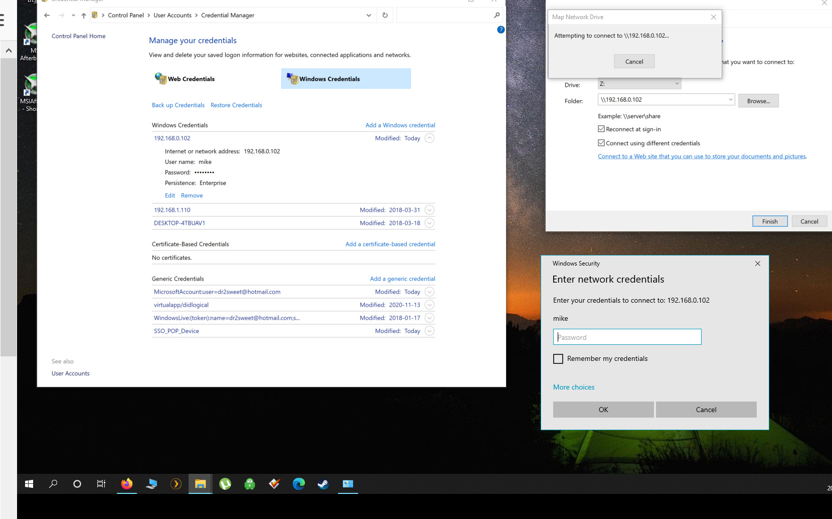

i tried to map the network drive but i get the credential login screen …
i created user credentials to match my user name in the my cloud setting. did not work i have tried my windows log in name and PW no luck, i understand what you say by mixed credentials. i think i have no clue what credentials are what. i thought the Mike user profile is for internet access. i just dont know what credentials i suddenly require to to access through windows ten on the LAN that windows seven is fine with out.

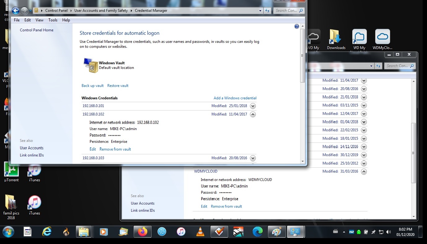

Some troubleshooting suggestions. Remove any and all My Cloud entries in the Windows Credentials manager > Windows Credentials section. Then reboot the Windows computer and try accessing the My Cloud Share again with a My Cloud User who has permission to access that Private Share. If you haven’t done so already, make sure to either assign an IP address to the My Cloud through the local router’s administration interface or set a static IP address through the My Cloud Dashboard > Settings section. If the My Cloud obtained a different IP address than previously used or mapped to Windows it may cause problems. Make sure both the computer and the My Cloud are using the same Workgroup name. Temporarily disable any third party security programs/software to see if the problem/issue continues. Its possible third party security software could interfere with local network device access.

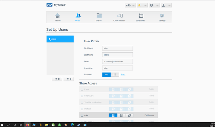

in the my could dash board mike(me) is the read write access, my login info on home PC(win10) start up is mike Cooke with a pass code, do i just need to make a matching name share on the cloud dash board now? i assume your term user would be my windows profile on this pc? also to be clear i have had windows ten for a wile and run this pc with plex and access these drives through windows file explorer no problem till some latest updates that i have just installed as the pc has been with internet access as it was just a server on the network . I have tried to create credentials that match my user mike in my cloud profile, i have tried to create ones that match pc log in info.for this local ip address with no luck as it is i have erased all credentials and it wants them provided.
Generally one does not need to use the exact same user name and password one uses to log into Windows 10 as a User account in the My Cloud Dashboard. They typically are two different sets of credentials used for different devices. One for Windows, the other for the My Cloud.

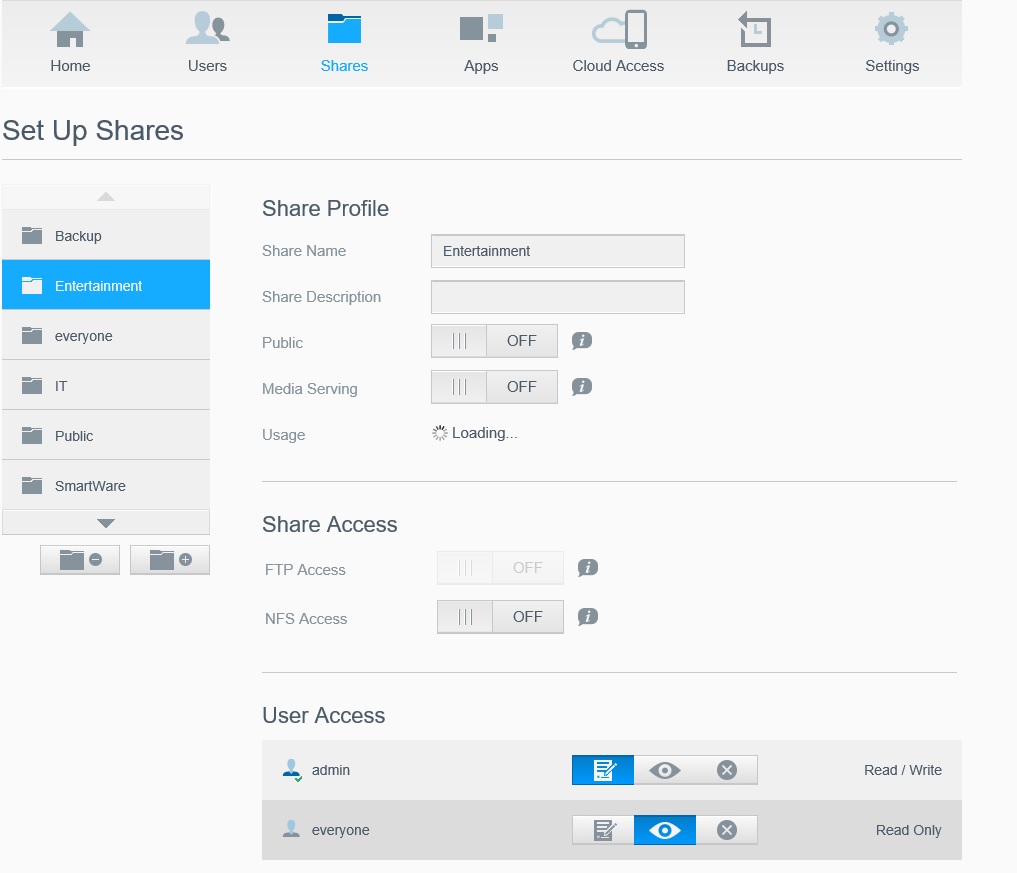

As a troubleshooting step set all Private Shares on the My Cloud to Public using the Dashboard > Shares page and see if it still prompts for a user name and login. Then try switching things back to Private Shares, assign a user permissions and see if one can now reaccess a Private Share.

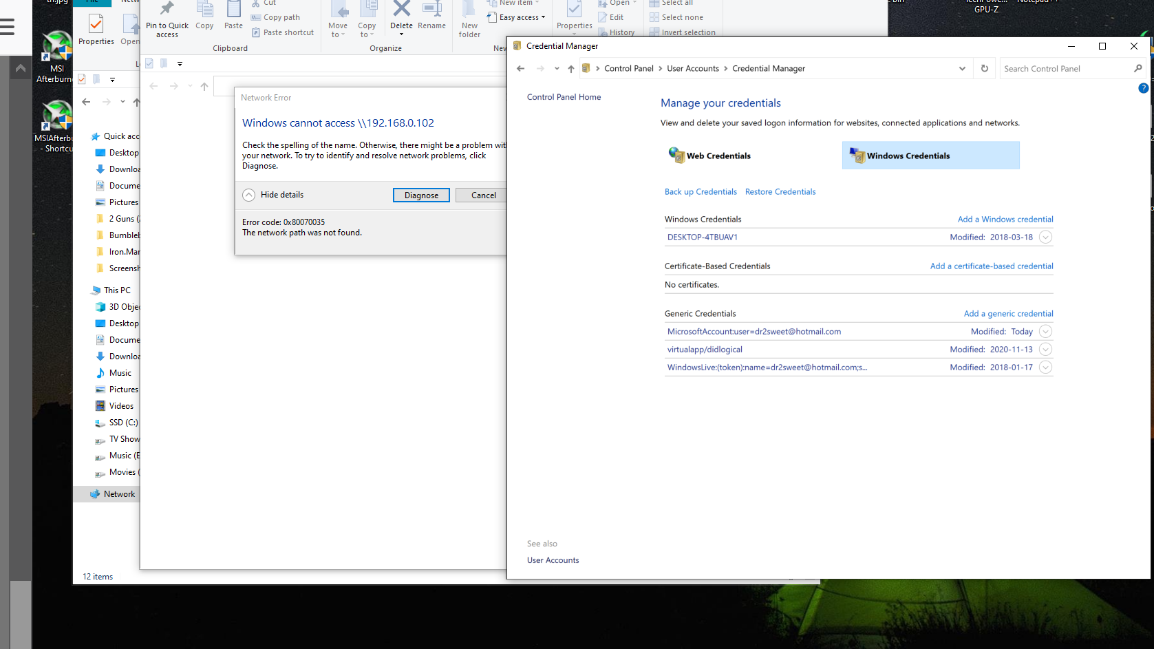

So Back to the Windows 10 PC if i have no credentials saved for that ip address, i get this…
when i add in the credentials for this root drive, i get the username and password box, but even though i know i just entered them its just says its wrong.
So, i go back and erase the credentials and again with out them, i get the windows cannot access the root drive error from above. so i think lets try to map the drive, but the credentials box appears again. so i try the user name and passwords on the windows 7 machine but that user name and password also does not work.

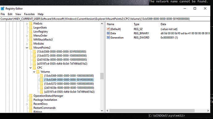

Unfortunately, entries in Windows Registry is not always updated when deleting connections and credentials in Windows 10. To do so, start RegEdit.exe. Export a .reg file as a backup.
Then go to:
HKEY_CURRENT_USER\SOFTWARE\Microsoft\Windows\CurrentVersion\Explorer\MountPoints2
Mark a connection to the My Cloud that you want to delete, right click mouse, and press delete.
Repeat for all connections to My Cloud.

i rolled back windows ten and removed a lot of up dates and nothing seemed to allow the drive to be found without credentials, i did try using some WD software and it clued me in to the fact that back when both these PCs were windows 7 the were on a net work i labeled WORKGROUP, tired accessing it that way, no luck
what if this recognition of credential issues are with the ones the other pc uses to gain access?
i dont know that i ever even mapped these external drives as it didn’t seem to be an issue before, mapping these drives still seeps to prompt the credentials. which maybe i no longer know what they are?

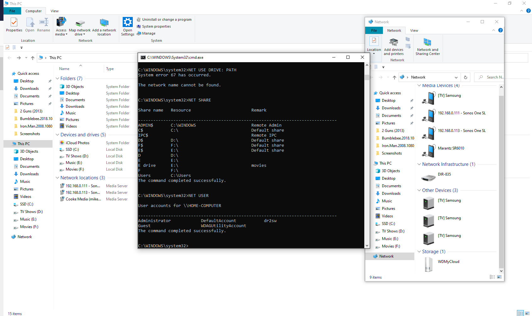

i am not great with command prompt but looked here, and found this on my pc
tried various guest, admin, dr2sw, workgroup, home-computer, mike, mike cooke, with a hand full of passwords that normally use for just these forgetful reasons. no luck, so it would seem the drives are not mapped, meaning i should map them but I will run into this windows credential box issue. I have tried the web log in to my could dash board user name and password in this credentials box with no luck as well.
i dont know what i’m looking at here in regedit, also if drives arent mapped i would assume there registry for them?
