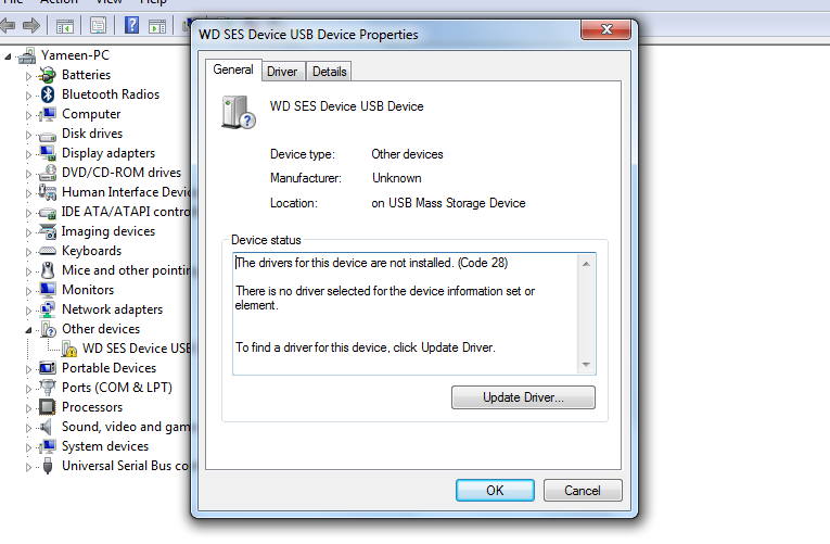

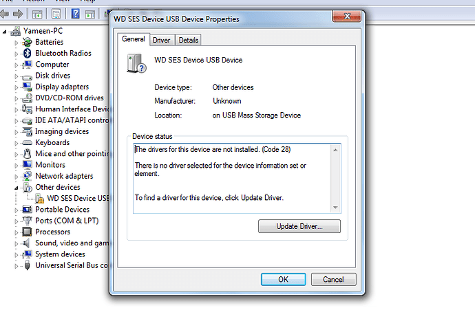

Download and install the driver here…
https://support.wdc.com/downloads.aspx?p=258&lang=en
The latest version of the driver is available through Windows Update, so make sure you you’re connected to the internet and have Windows search for an updated driver on Windows Update. You can also manually download and install that driver from the Microsoft Catalog website, making sure you select the version that matches your version of Windows and architecture.
The WD SES driver shouldn’t affect general usage of the drive, and it should work fine without it. I believe the driver is required if you want to change the drive’s settings (turn LED light on/off or change sleep duration) using the WD software.
