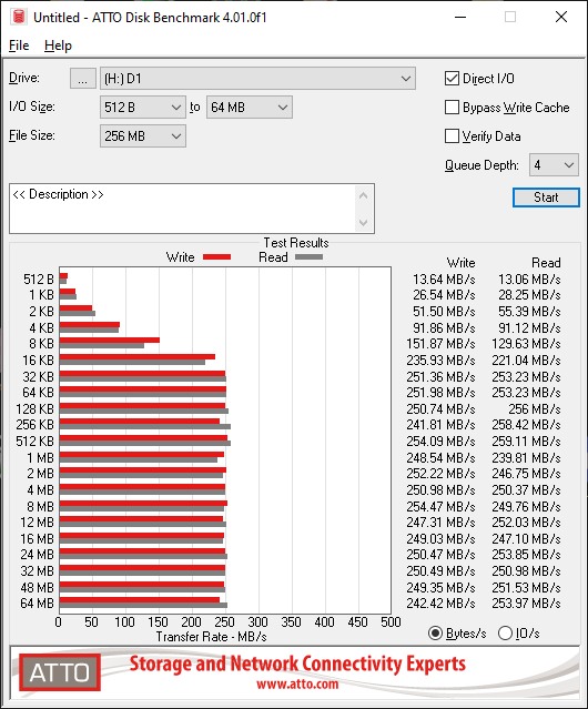

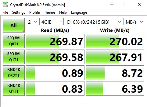

Hi, I bought two identical Ultrastar HC590 26TB Sata drives
They have the same firmware, manufacturing date, parameters, formatting, even batch is the same. Both completely empty and connected to the same SATA port during test. But one is 4-5% percent slower in synthetic tests. Everything else is fine. All SMART parameters are also absolutely identical in both drives.
Is slower drive faulty? Or maybe this is an acceptable speed deviation, due to manufacturing variations, etc.? I’ve never compared the speeds of two identical drives before. Perhaps such speed differences are normal.
If it is normal, then everything is fine, I don’t mind such a speed difference, it’s important that the drive works reliably. But maybe enterprise series drives should have absolutely identical speeds? In this case I would assume that slower drive is faulty and I would replace it.

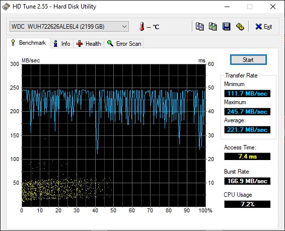

Can you show us a HD Tune read benchmark graph?

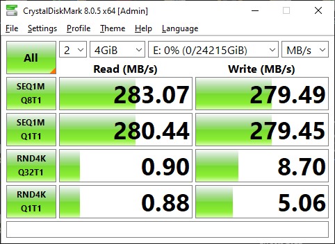

HD Tune read benchmark graphs and Crystal Disk Mark benchmarks.
Weird. It appears that HD Tune is detecting the capacity as 2TiB, which is the maximum capacity that can be reported with 32 bits. It’s not seeing the temperature, either.

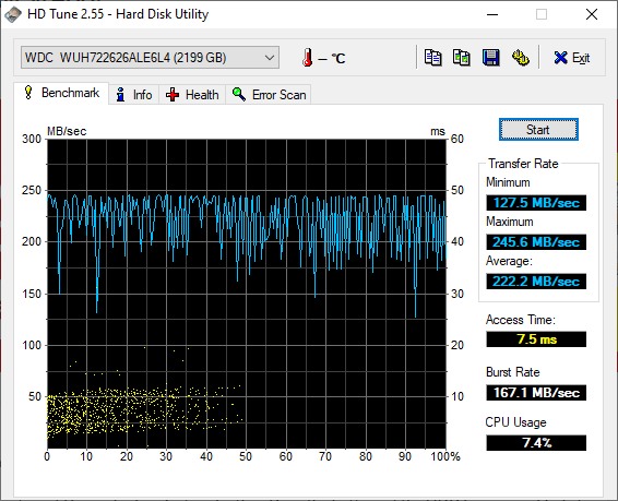

Anyway, the graphs look identical.
HD Tune is more like “real life” read test. Also, it averages the results. In this scenario my HDDs look identical.

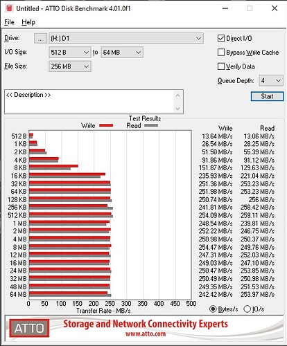

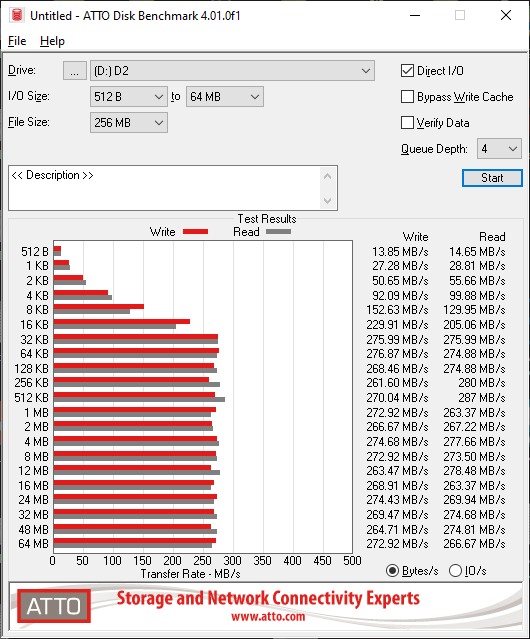

But all synthetic benchmarks (like CrystalDiskMark, ATTO, etc.) always shows one of the drives is slower by 4-5%. And I want to find out why it is so. It is very clearly visible in ATTO graph.
BTW, HD Tune it is very old software (from 2008?), I’m not sure if we can fully rely on it.
No, my HDDs are not under RAID controller. They are simply connected to SATA port on my motherboard. During tests I connected them to the same SATA port.

Yes, I see SMART attributes (including temperature) in all other programs, except HD Tune – it is simply too old program, and it is not even officially designed to work on Windows 10/11, only on W7. I checked „HD Tune PRO“ – it is commercial, but has a 14 days trial period. It shows everything correctly. I usually use Hard Disk Sentinel. It also shows all SMART attributes correctly with real time updates.
Neither program shows any errors or warnings. All SMART attributes are below allowed thresholds and SMART values are exactly the same for both drives. Also, both drives passed full diagnostics with Kitfox software without errors or warning.
So, the question still remains, why is one drive slower? :).
