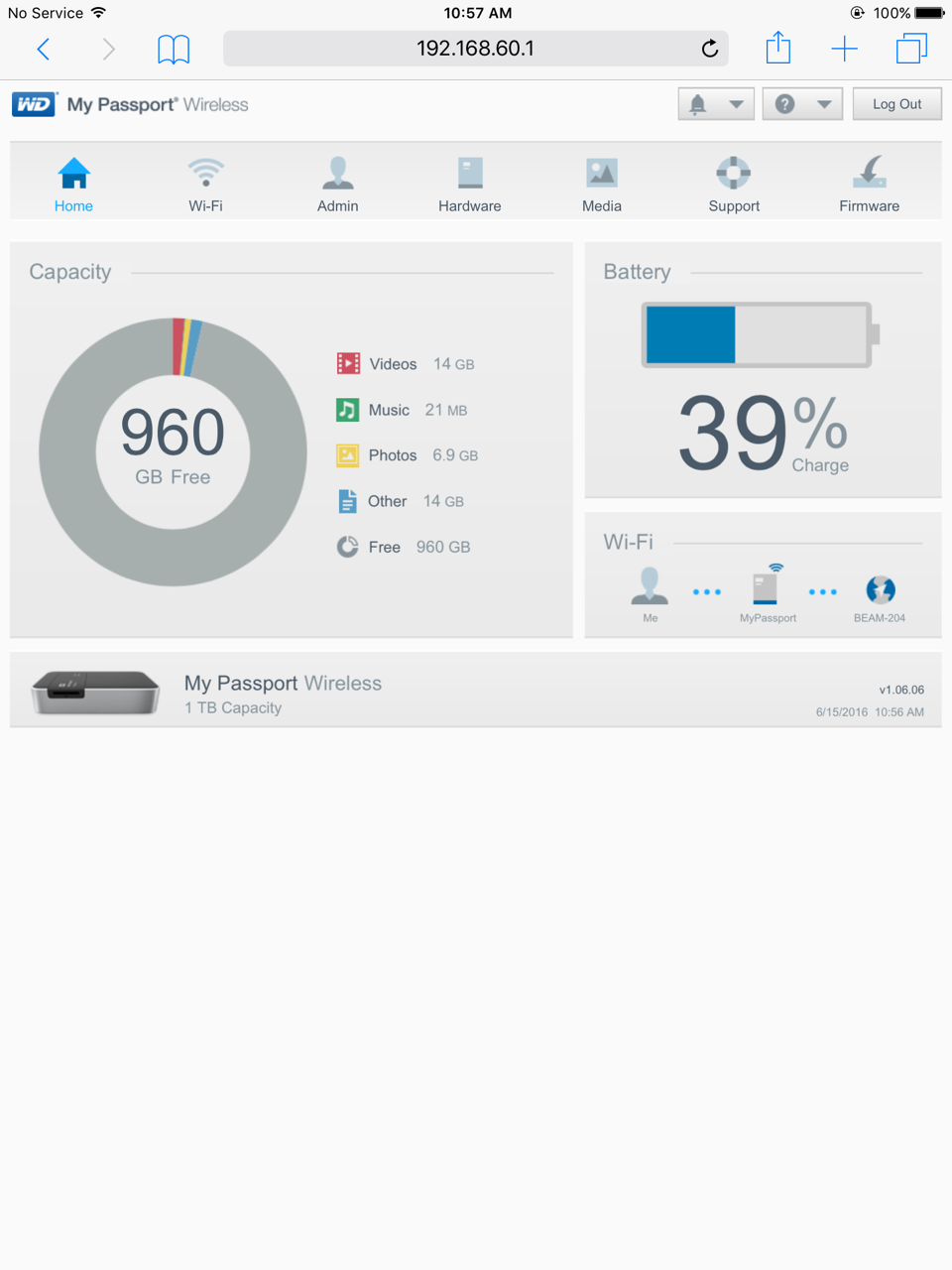

Mike,
The earlier mail and this one are screenshots of my iPhone and iPad wirelessly connected to My Passport and accessed.
This sis NOT happening on my Mac.
Regards
Anand
Hmmm, you have shown screen shots from the phone and pad of the MPW Dashboard as viewed from a browser on phone/pad, and photos as seen via the My Cloud APP on the iphone/iPad,
If you are expecting to see same view of photos on a computer (PC or mac) when using the mycloud.com access, I don’t think you can. A computer and a mobile device do not work the same way with a drive, any drive, including the MPW. If you want to “work on” and edit your photos on a Mac, you need to copy the photo to the Mac, use the Mac editing program and edit it that way, and not when the file is still on the MPW.
